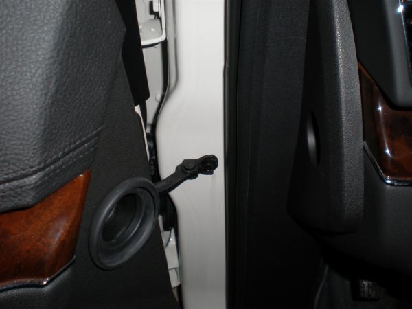

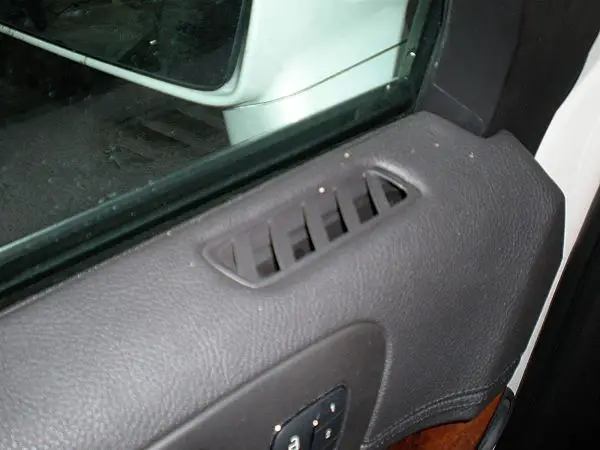

I don't know if the newer models have the same setup as my 2011 Limited had but here is what the MKT has. I don't think it would be that difficult to put into the Explorer if it hasn't been.
