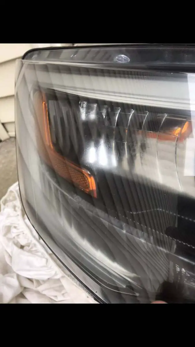

I got this today from one of my contacts at a large US Police Fleet. Just something for the guys with PI Utility's to be aware of and watch for.
Another issue that surfaced recently, here -- might keep a lookout for it-- only on the LED headlamp units 2016, with daylight running lights--
Lense- mostly the right side is discoloring-- I think it’s from UV’s from the LED- as it patterns to the light being emitted from the bulb--causing the plastic to discolor or haze-- its on the inner section of the headlamp- we cleaned the outside - no difference.

Can you confirm its hazing of the plastic and not moisture?
Wonder if this will become an issue with the civilian version. They have the same headlights, don't they?
Confirmed not moisture.

That's interesting-- The mottling really makes it appear to be moisture even though the OP said it was confirmed to not be moisture. It might have to do with the pics being taken in the dark with the headlights on in the first photos, those headlights almost look mildewed.
True discoloration would be degradation of the plastic such as pitting, crazing, melting, or yellowing, and it doesn't really look like any of those things. Methanol certainly wouldn't be able to clean-away degradation, either, but as a reasonably gentle organic solvent, it would potentially work really well on residue resulting from condensation inside the headlight.
I wonder if these are two different problems, or if the OP's problem technically wasn't moisture (obvious beads of water clinging to the interior of the headlight lens), because it was the dried residue left behind by condensation.
Mine looked very similar to Sgt's post in the beginning with the lights on. Mine was some kind of grunge buildup that slowly dissolved with the methanol. It does seem like any normal condensation in the housing pooled the grunge and made the lines and spots. After cleaning my "bad" housing I can now tell the other housing has some more even buildup without the spotting, but not nearly as noticeable until I saw what a crystal clear lens looked like. Next time the front clip is off I'll get that one too. I'm just happy it can be fixed because light output was definitely diminished.
