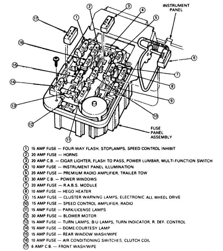

Hey,
I own a 1992 Ford Explorer and the radio just stopped working. So I was just wondering if anyone had the fuse box diagram, so I could see which fuse it is?
I don't know the fuse diagram but you can check any fuse that is 10, 15 or 20 amps. It shouldn't be anything higher or lower. If all of the fuses check out, you'll need a multimeter and a set of ford radio keys. The keys are cheap but the multimeter can be expensive...
Hope this helps!
