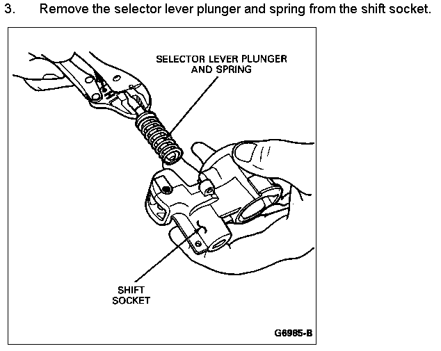

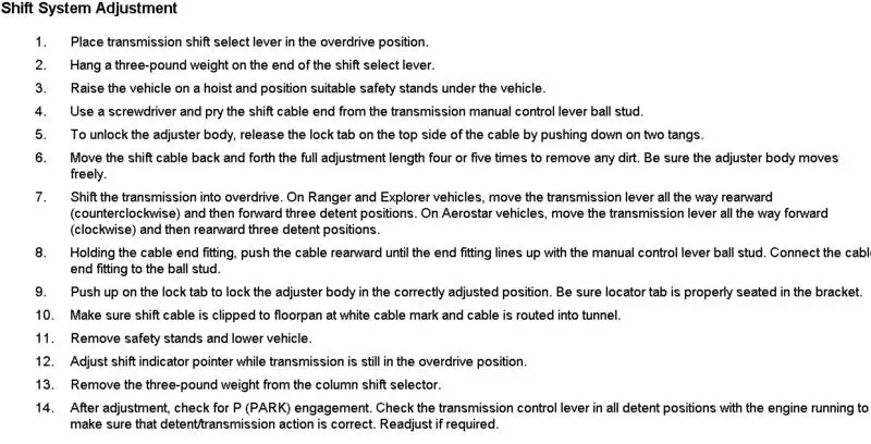

Attached are shots from the Ford service CD on removal and adjustment.

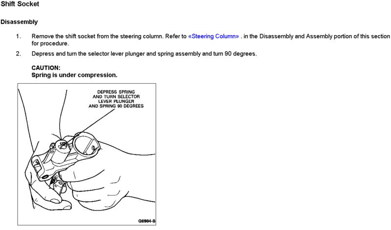

Not sure if you'll need this or not, it was in the steering column section.
