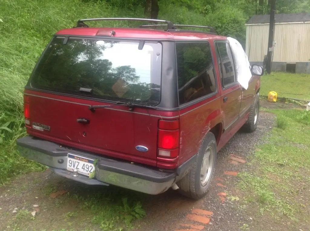

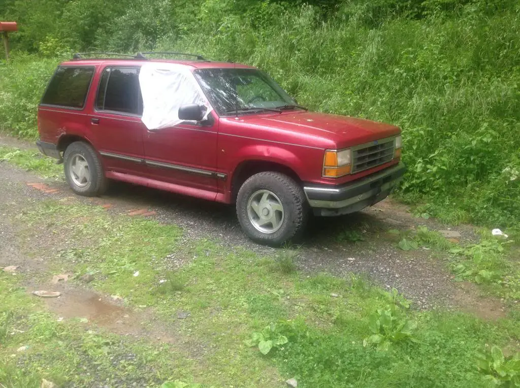

As mention in my new member forum I have a 1994 Explorer XLT 5 speed. It's my second 1st gen and I love it. She's pretty well loaded, power windows, power locks, sunroof, auto dimming mirror, keyless entry that works flawlessly. She has nearly 200,000 (184,900) to be exact. But she runs like a new truck. Very well maintained throughout her life. 100% stock at the moment. She does have a few problems however. The leaf spring shackles were rusted to hell. One is entirely gone. I got one nut removed but the bolt will not come through the frame and I can not get the nut off the bolt that goes through the spring. I wailed on the top bolt with a sledge hammer and it will not budge. I've doused it in PB blaster and let it sit and still nothing. Any suggestion? I just put wheel bearings, a caliper, and rotor on the passenger side. My 4x4 does not due to the cam assembly being destroyed on the same side. I a large portion on rust on the passenger rocker but it's incredibly clean for a vehicle of this age in my part of the country, also the radiator support is rusted to hell. The passenger side window motor is bad and the window is stuck in the down position. So with all that being said I plan to fix all the little things and then start upgrading. Does anyone know what other brake calipers will fit on the front without modification. Also stupid question but my wife hates the fact that it doesn't have airbags. Is it possible to put a steering column and dash out of a 1995 model in to add airbags. I know there is a lot more involved but is it possible? Is it possible to swap out the entire front end from a 1995 and what all would be involved? I'm just trying to build a better nicer explorer to enjoy for years to come. Thanks a bunch and I'm sorry if this has been covered before on here, I'm just not good at using the search. :feedback:
If you want to keep the rubber bushings in, your best bet is to keep soaking the bolts with PB blaster and keep at it with the sledge hammer over and over a few times a day until it works. You can also just drill/cut/burn out the rubber bushing and get new polyurethane bushings to replace it.
One trick I used when removing the stock rusted bolts was to remove the top bolt, pivot the shackle/raise the frame, put the bolt back in, then drop the weight of the frame on the shackle - this, along with the anti-rotation tab on the lower bolt, and the flange on the shackle made it twist the bolt in the bushing - and busted it loose. This won't always work, and sometimes the shackle is too rusted away or the tab isn't in the right spot to use it like that, but just something to think about - use weight and jacks to exert force when what you can do with human power isn't enough - but do it safely.
The 2-piston calipers from a 93-97 Ranger with the TTB will work, but you need to swap over the steering knuckles as well. Not really worth the $$$ involved unless you can find a parts donor or the parts at the junkyard for cheap. Good brake pads/rotors and having the hydraulic system in good shape lets the stock brakes work fine.
You can swap the front end of a 95-97 or even a 98-01, but it can get pretty involved.
If it needs a new radiator support, then the best thing to do is get a donor vehicle, and swap over the radiator support from that, then the hood, fenders, and headlights/trim should all fit. You'll need to move some wires or use adapters for the different headlamp bulbs.
Swapping in airbags would probably not be a good idea unless you REALLY know what you are doing. Obviously a system that didn't work would be useless, and one that might even malfunction and activate while driving would CAUSE safety issues. Part of the reason people like the first gens is that they DON'T have airbags. If you want airbags, like the look of the 95+ front end, etc. you may want to sell your first gens and get a second or third gen instead.

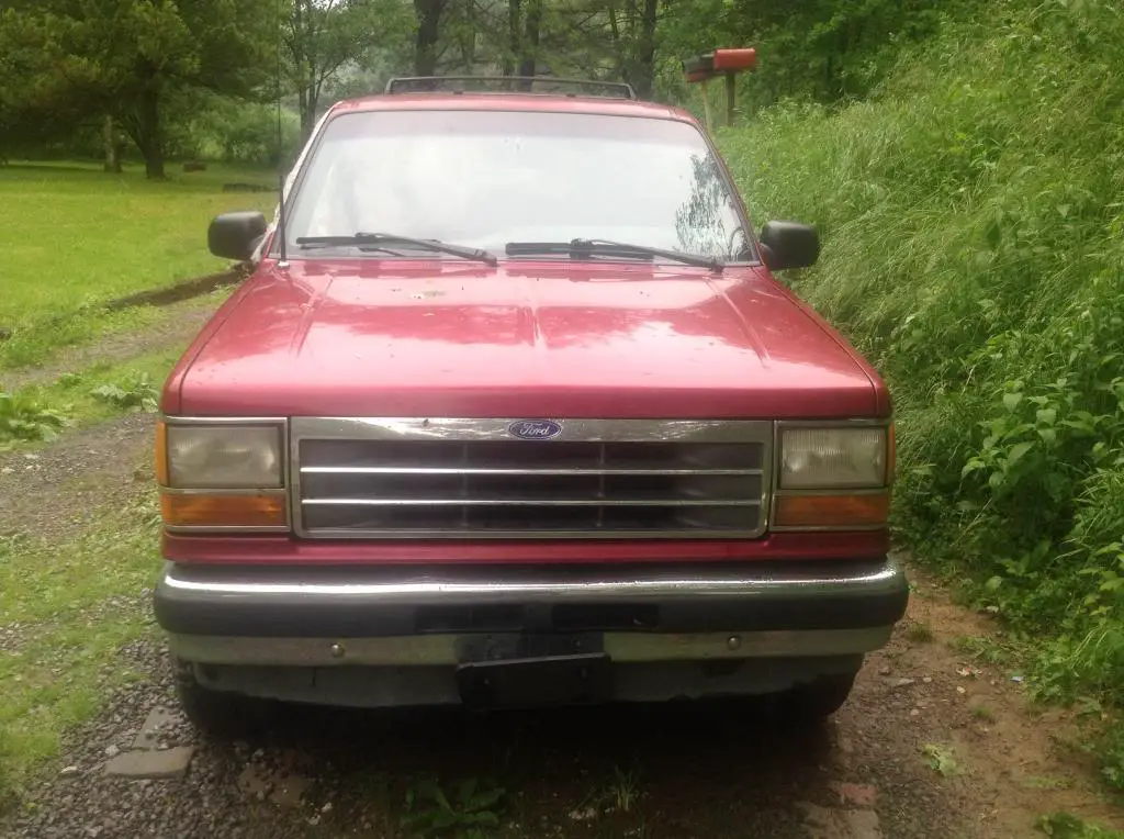

Hey thanks a lot for the info. I will probably go with the polyurethane bushings instead of trying to just get the bolts out. I suppose for now the brake upgrade may not be. Worth it but perhaps some time in the future. As for the airbags I don't really care about them myself. It was more of an idea for my wife, I know there would be a ton involved in doing the swap. I personally don't like second gen. Explorers, I just think they're ugly. Also was wondering what makes the front bumpers sag? And how can it be fixed
The front (and rear) bumpers dont 'sag', they are usually in odd positions from a collision.
The brackets that mount the bumpers to the frame have some play in them due to the bolt holes being slotted, so sometimes it's just a matter of loosening the bracket bolts, re-positioning the bumper, and tightening the bolts.
If the brackets and/or bumper itself is bent, sometimes you can still get enough adjustment to make it look ok, or the slotted holes in the brackets can be enlarged to give more adjustment, but sometimes the bumper and/or brackets may need to be straightened out before you can get any adjustment at all.
