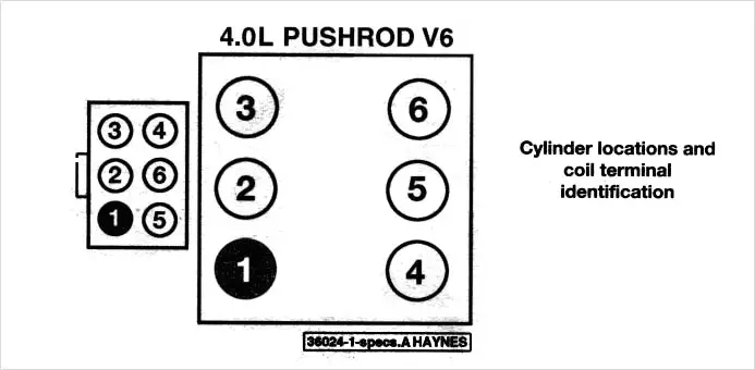

The only thing I am questioning is the plug wires and order on the coil pack which I cannot find a good diagram.

Sorry.....but can someone confirm that firing order listed above. Confused because it is in German and I thought the front cylinders were 1 and 6 not 1 and 4. If that is true....I have the plug wires all wrong and have zero idea how it's running.
The diagram is correct. You’re firing out of order, which will cause all sorts of issue. You’ve essentially got 2 cylinders out of time which will beat holes in your pistons if you aren’t lucky.
OMG.....I was going off how it was previously.....yes someone else was monkeying with it.
