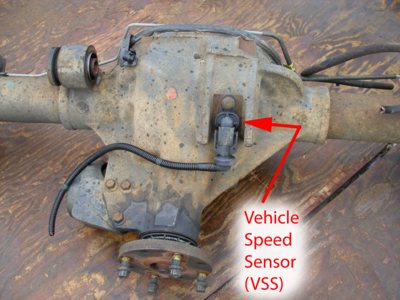

Hi everyone, new to the forum here. I recently bought a 1995 Aerostar AWD. Its in great condition, with only 100,000 on the 4.0 V6. I've been replacing parts on it that needed attention. And then I came this bushing the sets on top of the rear axle next to the housing/differential.
Apparently the bushing, is obsolete. I think its called the "suspension thrust bushing"? Does ANYONE please have a source for an aftermarket bushing. Or one from another vehicle that works. Or does anyone know of a place that makes custom bushings? I can't believe Ford would make this bushing obsolete? I haven't been able to locate one of these. Thank you in advance for any help or tips you can give me in getting this fixed!

Hi and thanks for your response. No this is an actual bushing. The housing its pressed into is cast on top of the rear axle. Just to the left of the pumpkin/housing/differential. My local ford dealer as well as many other resources says the bushing is obsolete. But I can't accept that there isn't SOMETHING else that will work.
I'm trying to figure out how to post a pic of it.... Ok here it is. Its the one just to the left of the differential.

I'd look at 1993-1998 grand cherokee bushings. Get a poly one cut and press the sleeve from the 8.8 bushing in.
It is very common for the dealer to have 'obsolete' parts. Some models go obsolete after just 4 or 5 years. The bushing is for the control arm that bolts to the top of the axle. Rockauto has them. Go to suspension and look at rear control arm bushings. There is an upper and lower just like a front control arm.
They can be very difficult to change with basic tools. You may be able to do it with a ball joint press, but a big hammer will probably work best if you only have basic tools. Make sure you install the new bushing the same depth in its bore as the old one. This will make reassembly, of the axle into the vehicle a little easier. Also if that bushing is bad, most likely the bushings on the other end of the control arm are probably going or in the same shape as well. I would plan on replacing them all.

Funsun98, I made out ok. I got lucky! Upon taking out the threaded bolt from the top of axle housing end of the arm. I found that the threads on the bolt were significantly worn away. Causing play that I thought was the bushing itself. I took the bolt to Fastenal. They matched it up with a higher grade "shoulder" bolt. Eliminating all the useless threads that slide through the middle of the bushing so it won't happen again in its lifetime. Have you pulled the bolt yet? Maybe you'll get lucky like I did. Let me know what you find!
