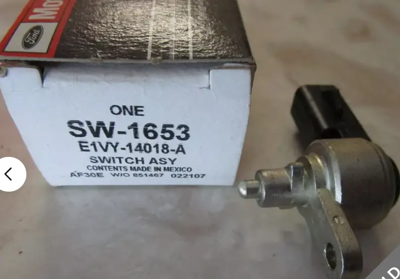

  • The driver side door switch pictured below
Located as per picture below (single 3/4" sheet metal screw holds it in at the top, rotate a 1/4 turn to remove once screw has been taken out)
View below (pulled this photo off the web) is "looking towards" the outside latching area of the door from the inside of the door compartment.

My issue was the switch had actually snapped in the middle, so the lead was just hanging in the door cavity.
Anyway, removed and replaced.

Incidentally, this switch seems to be a ground switch -- single terminal, continuity when plunger depressed (i.e., door closed), switch open (plunger out) when door opened. I would never have guessed that this is somehow wired into the GEM and also related to the headlight on chime, yet here we are, with a fixed headlight chime.
