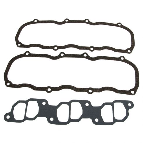

Now to make a fool out of myself. Gasket set came with 6 rubber gaskets. 3 of which go in the Upper Intake Plenum...the other 3 I assume are for one of the other applications this gasket set covers....
My real question is, is what is that bottom gasket in the image for??? I don't recall removing this gasket, just the 3 rubber gaskets in the plenum...
Besides what that gasket is for any help in determining the cause of rough idle as well as lean issues?
