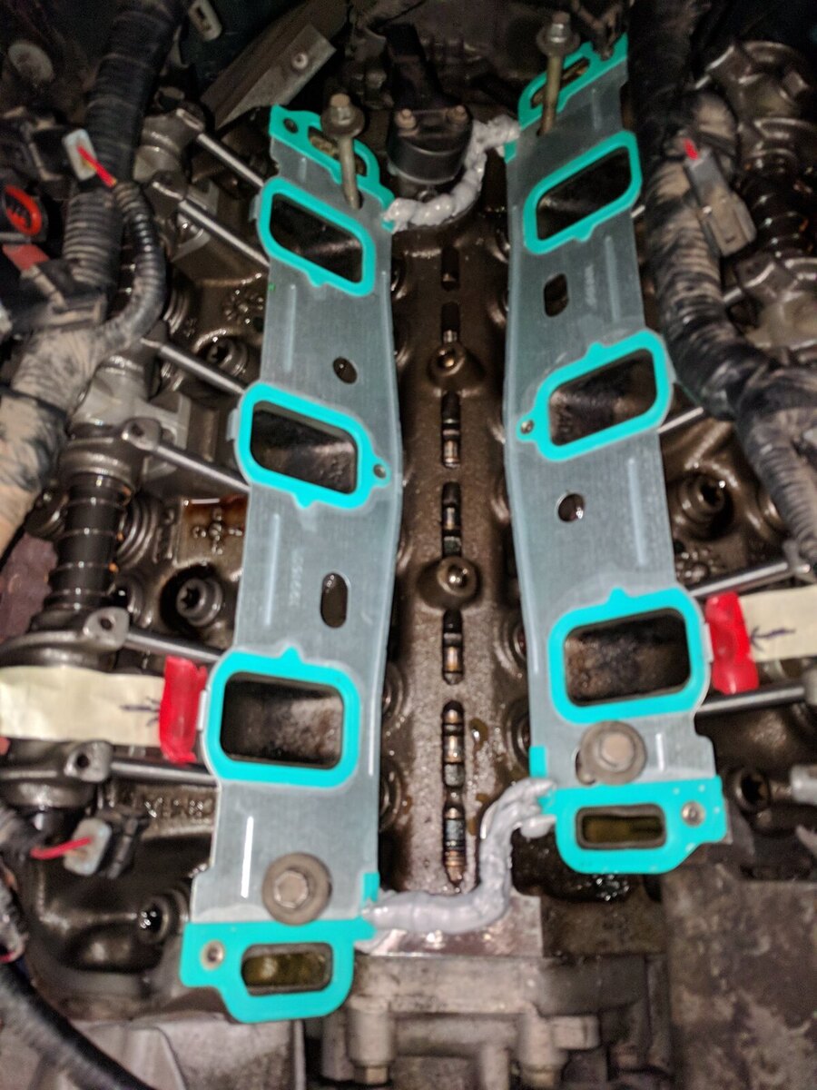

Below is a pic that shows the lower intake manifold gasket (green) that surrounds the 4 narrow coolant crossover ports (near the big bolts) in the lower intake. The 6 larger ports surrounded by the gasket are the air intakes for the cylinders.
The coolant crossover ports can leak coolant to the outside and/or the inside of the engine. Outside is not a big deal, but inside is a problem and you should check your oil level isn't rising from contaminated coolant which will destroy your bearings.
Removing the upper intake takes the most amount of time. After that you only have to disconnect the fuel line/injector harnesses, tap off the valve covers, pry up the aluminum lower intake, clean, and reassemble.
