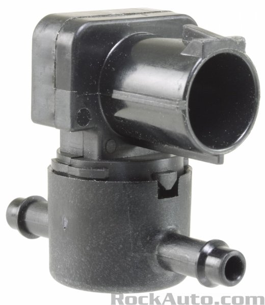

Here is a picture from ROCKAUTO.
Also here is a link to the part, this may or may not work right.
Purge Valve Solenoid
Should I be able to swap one from my '97 MM parts vehicle for diagnostic purposes before I purchase a new one? and is this the one on the drivers side under the battery? Do I work from the top side of bottom? Thanks in advance guys for any help.

It has been a while but that doesn't look like the one under the battery.
Also as I said it's been a while, but IIRC access is good from underneath, but I am certain I did at first remove the battery tray.

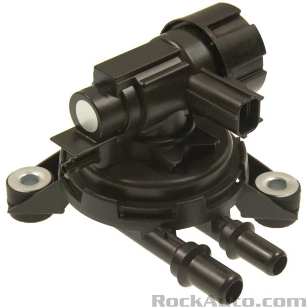

I was trying to remediate an emissions code. I did disassemble the piece under the battery, it has a larger diameter (for a diaphragm), and is simple mechanism, solenoid, diaphragm, and spring.

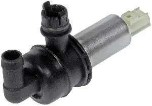

@drdoom Does it look like this?
That looks like the vapor canister purge valve under the battery tray
Remove the battery its rite there
This is the vent solenoid above the spare tire
@donalds Thanks! That is the area (the front left) that the smell is coming from. I'll look on my '97 MM after I finish the accumulator/dryer install and pull a vacuum on this 1970 Mustang that is currently on the rack.
