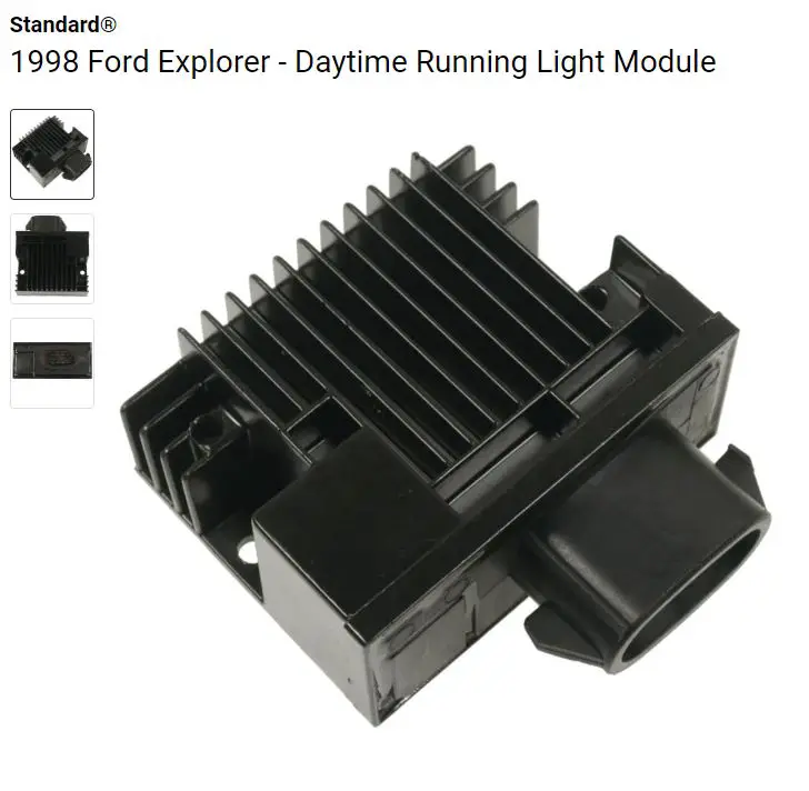

The daytime running lights have finally started flickering on my '98 XLT. I've read quite a few of the previous posts regarding the location but I'm still not sure where it is or what it looks like. Most of the older threads that had pictures no longer include the pictures. I'm attaching a picture of what I see behind the drivers side headlight. I see nothing that looks like the replacement module.
I've been looking for a 1999 XLT's DRL module and have been coming up empty as well. Closest thing I could find turned out to be a crash sensor according to the part number on it.
My current theory is that, at least on this particular car, there is no DRL module and the problem I had was the rear view mirror with the auto lamp feature. I "fixed" my problem by cutting the green wire in the wiring that goes to the mirror. Now the headlights actually turn off. No auto lamps though.

Oddly, same workshop manual, on the same/equivalent link for a '98, has more info and a picture. It does not list a fault where it flickers, so I'd wonder first about wiring and connector corrosion. The whole 2nd gen workshop manual this came from, is linked below in my sig, and there is a forum topic/posts about it.
Thanks for the links to the manuals and wiring diagrams! Based on the diagrams, it does seem like the 8 wire(greens, red, white, ect.) connector in my picture is for the DRL module. I'll have time over the weekend to see what I can figure out.
Sorry guys for not responding as I said I would. Lots of distractions lately. Anyway, it looks to me like my DRL module matches what the Helms manual shows for a '99. The picture that J_C posted for a '98 doesn't match what I see(first picture in the post). I did end of resolving the flickering which was caused by the autolamp switch on the mirror. A little contact cleaner resolved that. With the autolamps turned off, I still have no DRL's. I verified it's not relay related. At this point I'm not going to look any further. I can just turn the headlights on manually if I want.
