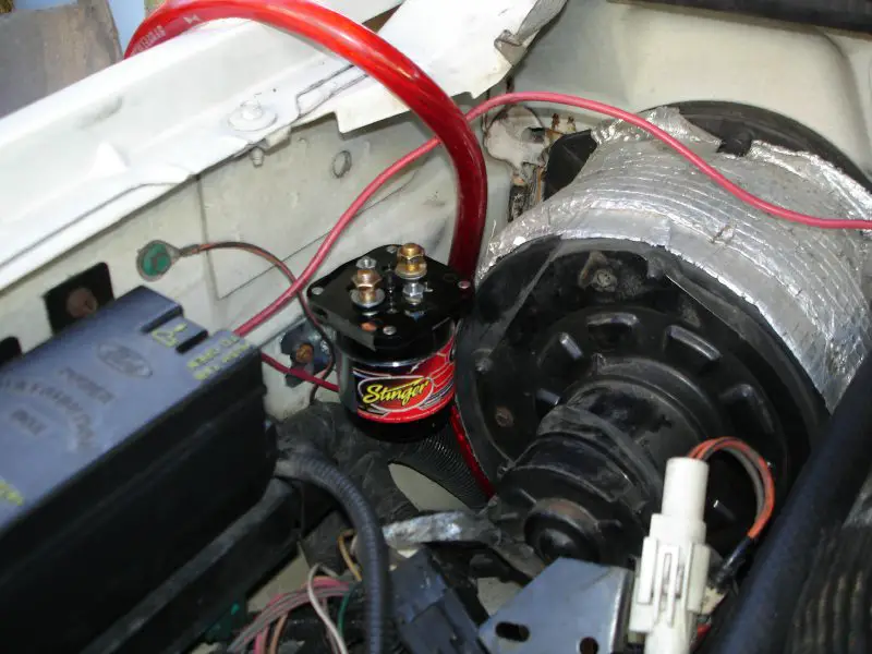

Yes. It's possible. I have done the same thing on my old set up.
I mounted a Stinger 200A Isolator (200A/12v Solenoid) on the inside fender, just above the A/C Fan.
And here is the 2nd battery mounted.

I'm glad you posted that up, how is the stinger working and how do you like the exterior finish quality? I'm slowly collecting parts for my dual setup and next paycheck I plan on purchasing their 500 amp relay. At first it will just be my 200 amp alt, then the stock one is going back on; and I want to have the capability in the system to later upgrade the stock amp with another 200 amp, that's why the massive 500 amp relay, for anyone wondering.
