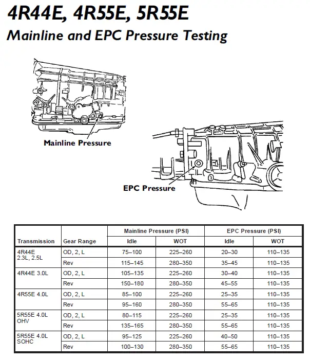

Here are the EPC pressures that i measured. The WOT pressures seem a little low in all the gears according to the chart below but, I am not sure if these pressures tell us anything that is a possibility to not having reverse.
Park Idle 55psi WOT 60psi
Reverse Idle 45psi WOT 80psi
Neutral Idle 60psi WOT 80psi
Drive Idle 50psi WOT 70psi

It finally quit raining and I pulled the valve body again. The 2-3 end plug and retainer are in the correct positions. The Reverse Modulation Valve is free and smooth. The Boost Valve is also free and smooth. I have an extra transmission and will swap the EPC, SSA and CCS solenoids before I put it back together unless, someone has another idea?
I just don't understand why the reverse works when the harness is unplugged but, not with it plugged in. I feel like a solenoid is mechanically stuck or something as everything check good electrically.
After replacing the EPC, SSA and CCS solenoids there was still no reverse. Fed up, I went to the junk yard and bought a replacement valve body. Swapped it this afternoon and the transmission works as it is supposed to. So, there was something wrong in the valve body that I could not find.
