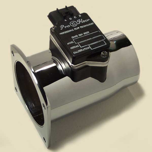

By the way guys, we carry the Pro-M 75mm MAF. This unit is custom calibrated for your specific mods. It is available in chrome or black. It will compliment your current intake, exhaust, chip combo quite nicely. Our price is $244.95. The chrome one goes great with the Mac Intake.

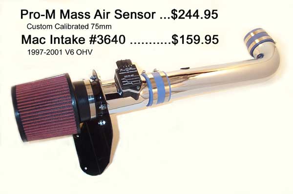

Here is the Pro-M 75mm mated with Mac 3640 Intake. We also carry the V6 SOHC, V8 5.0 & 4.6 versions. (see our web site)

John, a 75mm would work just fine. a MAS is usually something i just recommend as big as you can get, because if you ever run a blower it becomes the big restrictor. there really is no need for an 80 on an N/A application, a 75 will do fine.
james,
I believe the meter would need recalibration for a supercharger anyway.(or as pro m suggests). 80mm is like tossing 200 bucks in the garbage, it takes a huge amount of horsepower to out flow a 75 on a 5.0.
