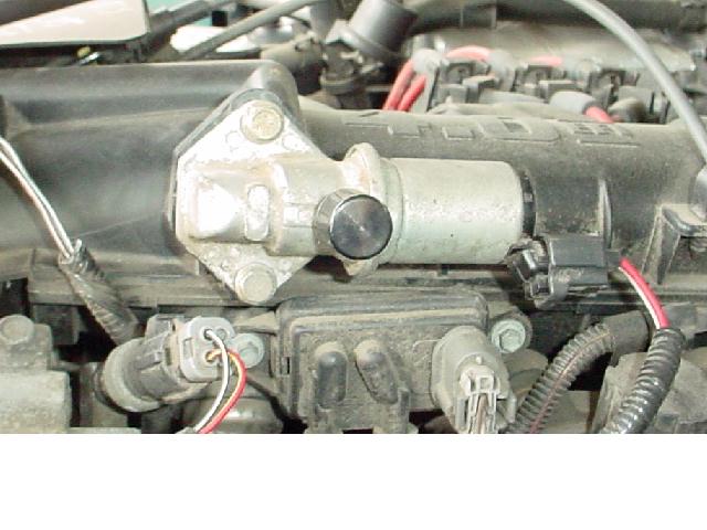

Check Engine on, getting P1507 error code, engine idles very rough, stalls when cold, bucks and jerks while driving. Problem is apparently the IAC valve, wiring, or something like that. Where is this thing (IAC valve), where is it mounted, and what does it look like? Can anyone post a photo with their reply? Is it that thing on the left side of the intake tube just downstream from the throttle, that looks like a gear motor, with a knob coming out of it? Please help!

Welcome to this forum! You are correct about the IAC valve. It has 2 small bolts holding it. Check the ECT sensor too. This picture of the IAC valve is from Karl Burns' photo gallery:

I haven't been to school on this engine, don't have a Haynes manual readily available, so I'm flying blind. Got the photo of the IAC valve. I did find a couple of rotted out hoses from the EGR valve tube up to what looks like a MAP sensor below the IAC valve, replaced those hoses a week ago, reset codes, but they came back in a couple of days. What is this other (ECT) sensor you mentioned, what does it look like, and where is it located? I'll try swapping out the spark plug wires tomorrow. #5 and #6 should be same length. Thanks!

IAC valve was stuck, pulled it off, loosened it up with penetrating oil, small screwdriver and needle nose pliers, cleaned and flushed with jet spray Gumout, and oiled with 5w-30 Mobil 1 oil. That got rid of P1507 error code. Apparently what I thought was a knob on it is actually a breather cap.
