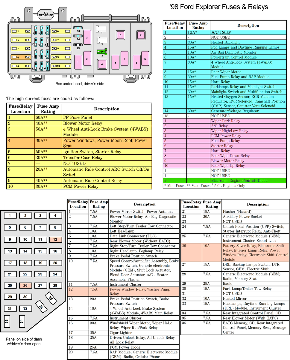

The drivers seat controls don’t work (passenger side does work), no radio, no fan, the Message Center info does work.
All fuses ( passenger and Power Dist. box) are fine.
The Relays ( all 10 in the Dist. Box) don’t appear to have any relevance to my problems.
Which fuses or relays relate to the above items?
I’m baffled so any advice would be appreciated.
Regards,
Graham Watson
Did all these things fail simultaneously, or did you acquire the vehicle with some or all these things not working, so there might be different causes? It does not appear that all these things are caused by the same fuse or relay.
There's lots of 2nd gen wiring diagrams linked in my sig below, or here's a fruity looking (easier to read on a color laser printer) fuse diagram for interior and power dist. box under-hood. It should match what's in your owner's manual.
Both L & R front seats operate off same interior panel #18 fuse, so I'd pull the harness connector and see if power is getting to the seat and if the ground has good, low resistance to chassis ground.
Does the radio illuminate, show the clock? The radio fuses should be interior panel, #20, sometimes #28 depending on sound system model, and #29. On some vehicle packages there's also #34 but it's for a rear control panel and CD changer, will not keep the head unit or amp (if so equipped) from working.
Do you have manual or automatic (EATC) air conditioning? I assume EATC since you mentioned a message center. Being a more complex circuit with EATC there is more to go wrong, but I'd start by checking whether there is power and a good ground at the fan connector. If there is, bad fan. If there is not, I'd suspect the fan speed controller transistor (aka by some, "resistor" but yours if EATC uses a transistor) module. There are several topics about these issues, and if a fuse is blown, it probably has some fault causing it to blow so the fault needs fixed first.
For example here's a topic where I attached the '99 Workshop Manual pages on Climate Control, and there's more info in that topic as well as others.

All the fuses are fine but I dont know how to test the relays but as your diagram of the relays under the hood (1 - 10 in pink) bear no relevance to my issues except No.9 (blower motor).
Relays, there's ways to test them such as checking whether they are getting 12V on the coil pin socket contact (when they should be triggered) and a good sub-5ohm connection to ground, and whether they are getting 12V when they should, and 12V out on the other switched relay contact. However it is usually quicker and easier to try swapping around the relays, pull another same type and put in the position of the suspect relay since it's unlikely that two or more relays failed simultaneously.
I have noticed on my '98, that over the years, fuse and relay contacts are getting a bit tarnished. Not badly so (yet) but another thing you could do is simply pull out and put back in a few times, any related fuses and relays as the mechanical abrasion on the contacts may help, or of course clean them off.
