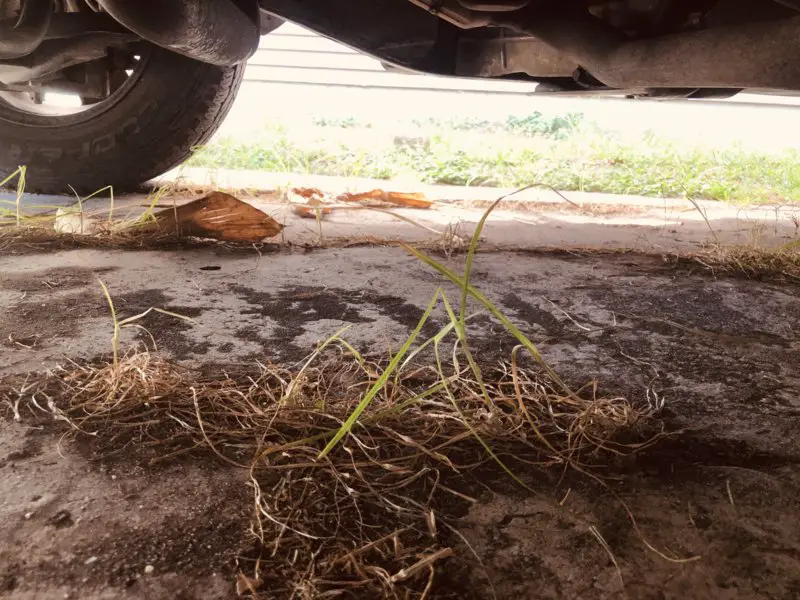

In case it helps, this is a pic of the new fuel filter from the driver’s side, a view from above the tire.
And it’s probably normal to have oil in driveway after changing the fuel filter I imagine?

That's the starter not the fuel filter. And it's not really "normal" to have oil in the driveway.
And if the mechanic sprayed down the bolts to loosen the rust off them he got some on the exhaust since there is an exhaust flange right there that hides one of the starter mounting bolts, that's probably the smoke you are seeing it will go away. I'd grab that small wire and see if you can wiggle the connector at all, it could be that nut that holds it in place is a little loose, hard to tell from the picture. If it is tighten it down it's a 10mm socket. It sounds like the battery was just.weak tho.
