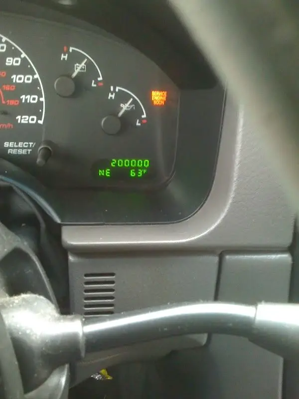

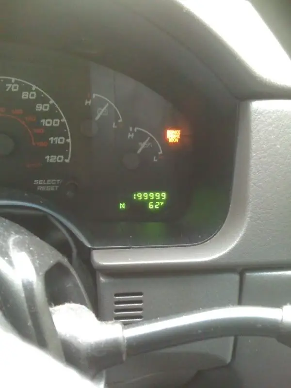

My name is Steve and I recently "inherited" this beautiful 2002 Ford Explorer XLT 4.0 SOHC with 201,000 miles on it.
Before its "birthday"
"birthday"
I got the "check engine light" checked out and it seems to be the o2 sensors. It had this light on for a while and never had any of its o2 sensors replaced.
