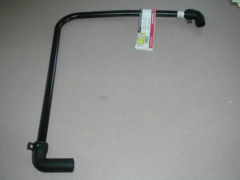

Replacement part KCV190 Motorcraft

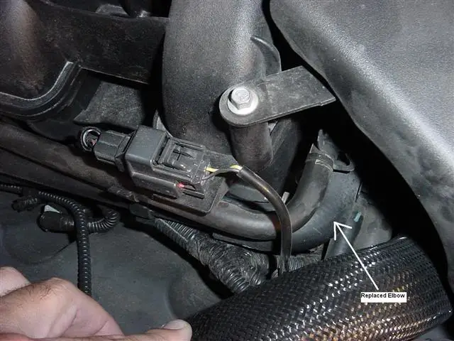

I decided I had better add photos!:thumbsup:
I appreciate it, lots of stuff under the hood and not a lot of room!
just get the elbow at kreagen. or your local parts store. cost me 6 bucks to fix it
Elbow was roughly 13.00 at napa, a far cry from the 58.00 ea. I was going to pay for the o2 sensors.

Either of you two guys care to post the part number of the hose you bought. Might save others a bit of trouble. Did NAPA/Kragen show an application for that or did you go by shape/dimensions? (I'm surprised if you found a parts person that can do that anymore!)
