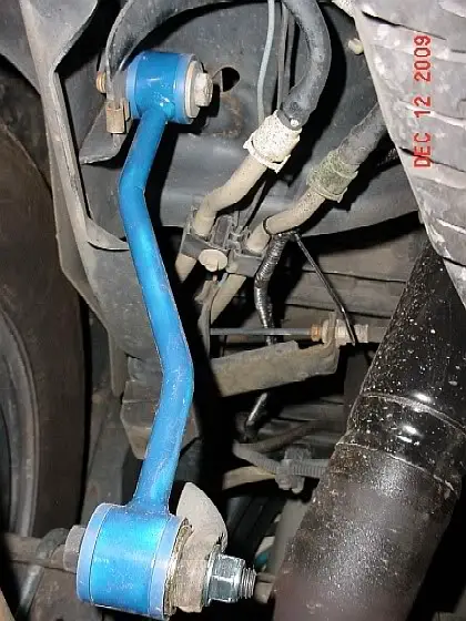

With that mileage you surely need shocks and probably sway bar end link bushings too. Get those in Moog blue polyurethane.
