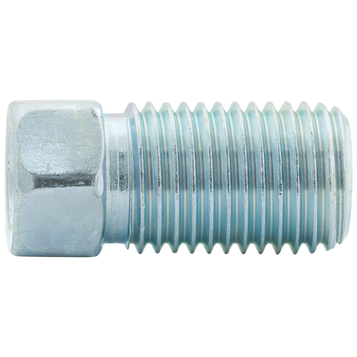

I am running into a bit of an issue with the lines and fittings that come out of the ABS. The smaller of the fittings is M10-1.0 bubble flare on 3/16 line. The flare nut is easy enough to find but even if I reuse the original fitting, I don't have a tool to do the bubble flare. The original fitting is more rusted on the hex than I would like anyway.
I know that, in theory, you can do a bubble flare with a double flare tool but I think it makes more sense to just get one of these,
SUR&R BSCE324 24" 3/16 NiCu Brake Line M10x1.0 Bubble Flare ($6.99)
This will give me a nice bubble flare and fitting and I can cut the other end to add the double flare and 3/8-24 flare nut to attach to the rest of the line. Does that make sense?
The other two fittings are M12-1.0 on 3/16 line. I have not been able to find a pre-fabricated 3/16 brake line with M12-1.0 bubble flare fittings. I almost despair anymore in trying to use any kind of search engine to find a specific part that I am looking for. I can search all day on "M12-1.0 bubble flare brake line" and never see any such thing. It seems I will only ever see what companies are paying to have me see, regardless of what I actually am looking for. Perhaps this just means that there is no such part, but I would rather be told that there are no search results than be given thousands of irrelevant results to waste my time wading through.
If I were to buy a couple more M10-1.0 bubble flare lines like the above and then separately buy M12-1.0 bubble flare nuts for 3/16 line,
4x SUR&R BR240 M12-1.0 Bubble Flare Tube Nut Fittings 3/16 Line ($11.99)
could I cut the 3/16 line, remove the M10-1.0 fittings, and replace them with the M12-1.0 fittings?
This would be about $20 for the lines and fittings out of the ABS, so is allot less than getting another tool to make the bubble flairs. Additionally, I would know that the bubble flairs were well made.
If anyone knows where to get a pre-fabricated 3/16 NiCu line with bubble flares and M12-1.0 flare nut fittings I would appreciate the link. I think that 1 30"-40" line would work best because I could cut it in half to make the 2 lines I need. That is not necessarily the most cost effective solution in all cases though.

Yes if I understand your intentions correctly, you could buy two lines, or one and cut it, then flare one end yourself. Personally I would try to reuse the fittings because I'm cheap, maybe just sand off the corrosion on a piece of sandpaper on a flat surface like a piece of glass or tabletop, but I can't appreciate how bad yours are. Mine weren't bad at all, especially the important part, the amount of threading that mates with the module.
Another thing you can do since this little run of line wouldn't be too hard to install as a pre-bent Ford part, is try to track down the Ford part #. It's probably discontinued, but someone might have new old stock of it, a parts supply company or ebay. I already checked White Bear Lake Ford and they don't have it, and the crude picture (drawing) they showed, I couldn't even be sure if it was the correct part. Ford really needs to step up their game and provide real, high-res pictures of parts instead of something that looks like a grade school kid drew it with a magic marker.

Do you mean to use an adapter?
The adapter for the M10-1.0 port is easy enough to find,
SUR&R BR505 3/8"-24 Inverted Female to M10-1.0 Bubble Male 3/16" Line Size ($3.33)
but I can't seem to find an adapter for the M12-1.0 ports. That should be something like an M12-1.0 male bubble flare to 3/8-24 female inverted flare adapter but a search on this only reveals a few brass fittings like,
Brass Adapter, Female(3/8-24 Inverted), Male(M12x1.0 Bubble) ($4.55)
I would prefer plated steel but I guess brass would be ok.
Do you have suggestions for the adapters? I really am having trouble searching for this stuff. It seems like sites are going out of their way to make it difficult to find the products that they are trying to sell. AllStar has literally dozens of prefabricated brake lines listed on Amazon, but none of they have any specs at all. There is nothing that says how long the tubing is, what the tubing is made of, how it's flared, or what size or type of fittings are on the ends. How on earth do they expect anyone to know which of all their lines they are supposed to order? That seems like an absolutely idiotic way to try to conduct business.

You can concert it to m10x1 to match the other line?
Alright, I will see what I can find locally tomorrow.
If I can't find anything around here, these might work,
10x 4LIFETIMELINES LTNA27SS 3/8-24 Inverted F to M12x1.0 Bubble M Stainless Steel Adapter ($12.99)
10x 4LIFETIMELINES LTNA25SS 3/8-24 Inverted F to M10x1.0 Bubble M Stainless Steel Adapter ($10.99)
With free 2 day shipping from Walmart this is pretty cost effective. I can install these to the ABS ports and then continue from there by fabricating NiCu lines with the 3/8-24 inverted flare fittings I already have. It's too bad that these only come in a 10 pack but I can probably sell the 17 fittings I don't need. I can get brass fittings as singles but they cost quite a bit each.
LMHmedchem
I did go ahead and order these,
10x 4LIFETIMELINES LTNA27SS 3/8-24 Inverted F to M12x1.0 Bubble M Stainless Steel Adapter ($13.99)
10x 4LIFETIMELINES LTNA25SS 3/8-24 Inverted F to M10x1.0 Bubble M Stainless Steel Adapter ($12.99)
Getting them from ebay instead of Walmart cost $3 more but I had some left over balance on a gift card that I used. I will install these to the ports on the ABS and then all of the flares and fittings will be the same. I will make new 3/16" lines with inverted flares and 3/8-24 flare nuts that will fit into these adapters. I will have enough adapters to do the lines from the master cylinder to the ABS as well, but for now I plan to leave the ones that are there because they are not leaking.
