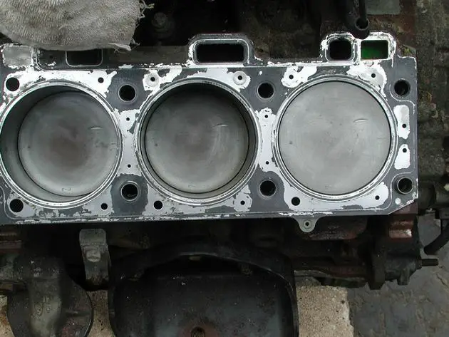

interfence engine
Yes, the primary chain tensioner and guide can be replaced with the engine in the vehicle. However, the SOHC V6 is an interference engine which means that the pistons can strike the valves when the camshaft timing is far enough off.
Damaged valves in both heads is an expensive repair requiring a special valve spring compressor. Head bolts should not be reused. The SOHC V6 is a complicated engine to time requiring a special timing tool kit (OTC 6488). It may be cheaper to replace the engine with one from a salvage yard. I suggest determining if there is valve damage before spending the labor to take the engine apart to check the primary chain components. Does your mechanic have a digital inspection camera with a lighted probe that fits thru a spark plug hole? If not, there's the old school method using an air compressor with a spark plug hole adapter and checking for air leaks when both valves in a cylinder should be seated.
