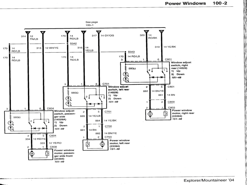

Hey all. My passenger side power window goes down not back up. This only works from the passenger side, no movement up or down while using the drive side master switch. No fuse prob, the lighted switch on the pass. side goes off when pressing the "up" on the drive side. Any ideas on where to get a schematic for power windows so I can further track problem?
my guess is master switch or a ground, here is a wiring diagram for an "04" should be the same
master switch, this happened to me as well. you can test it with a test light if you pull the panel off the drivers door.
