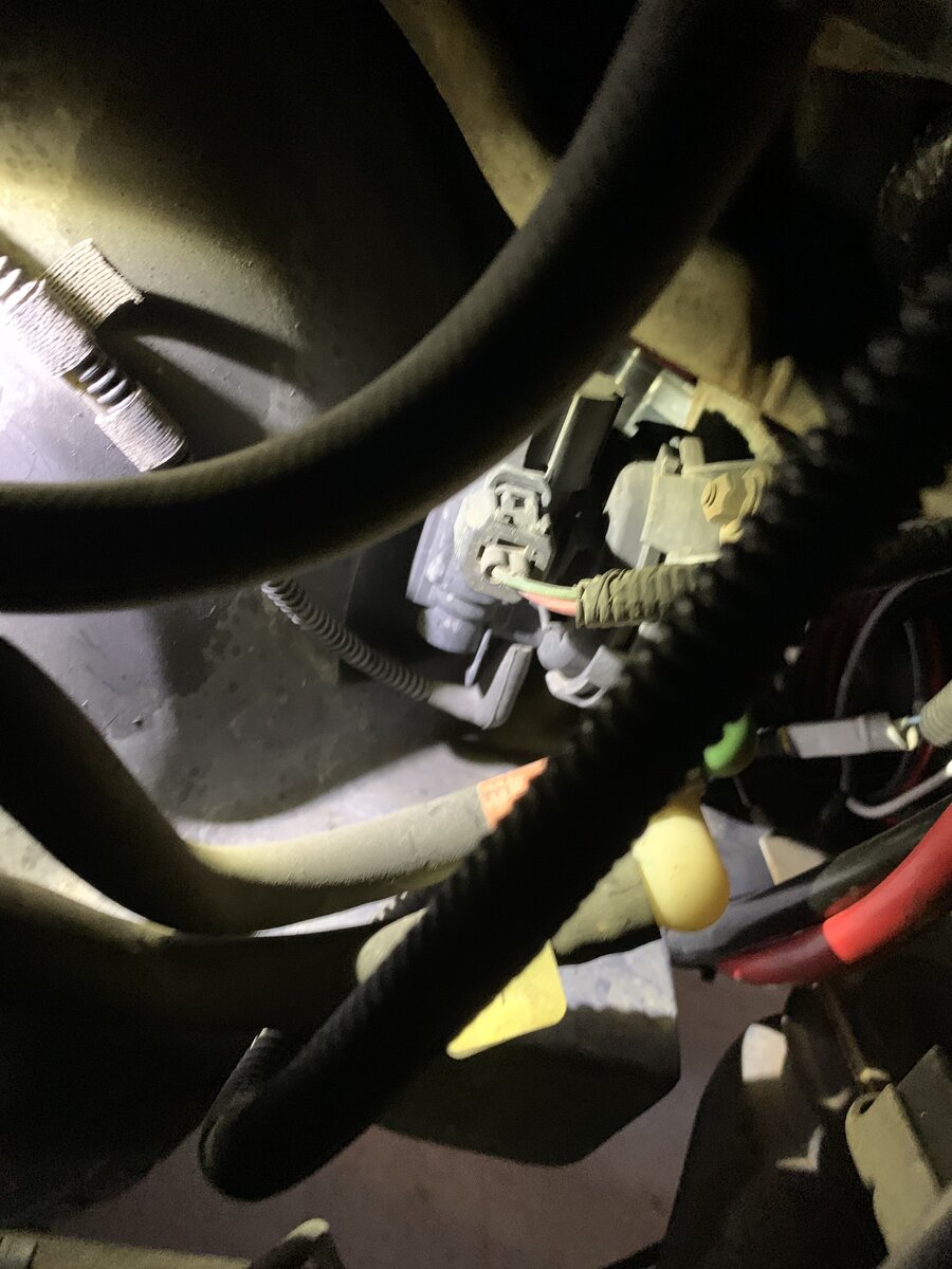

Hello. Does anyone know where the end of this vacuum line is supposed to plug into? In the attached pic, I circled the connected end with green, and circled the disconnected end in orange. The mechanic found the disconnected end hanging down by the driver side front tire during a quick-stop oil change.

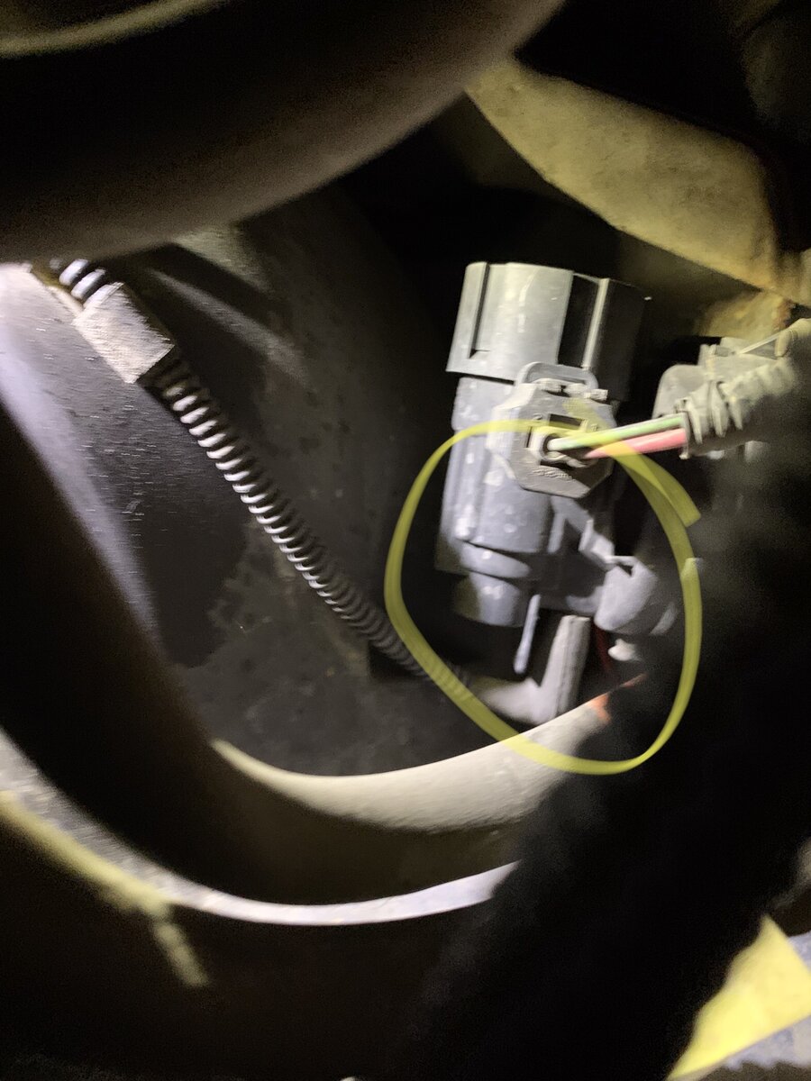

Here is another pic of the end of the vac line that is connected (which I traced with a green line). It's the other end of this line that is disconnected (circled in orange in above pic). I am trying to find out where to connect it to. Any ideas are appreciated. Motor is 4.0 SOHC on 2003 Sport Trac XLT.

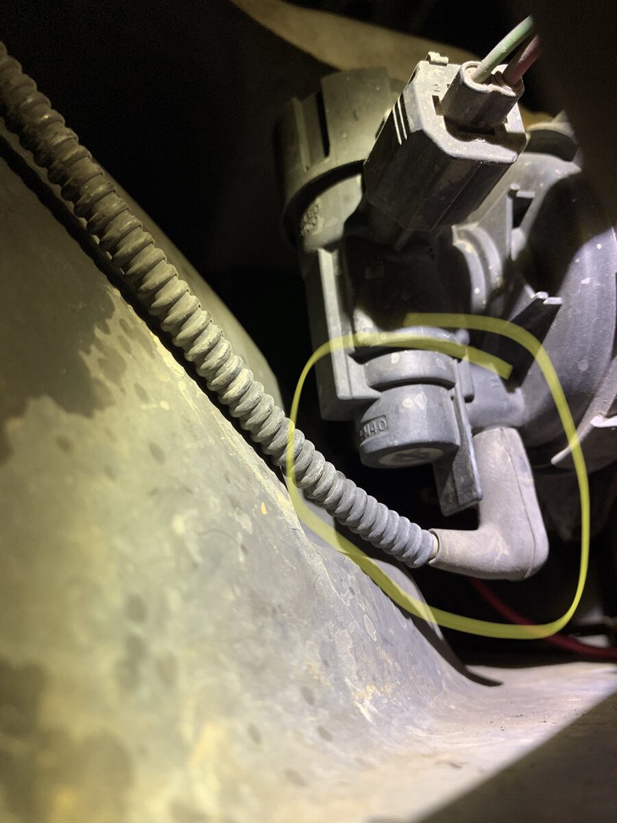

wrlcome to EF! let me check mine in a few hours i recognize that hose
so on my 98 its ubder the battery tray far down. perhaps these pics can help, it goes down then runs along the body then connects
so on my 98 its ubder the battery tray far down. perhaps these pics can help, it goes down then runs along the body then connectsView attachment 431615View attachment 431616View attachment 431617
Thank you so much for taking the time to provide this! This makes sense to me considering the mechanic found it hanging by the driver front tire. I guess I better stick my head up under the front/behind the tire and look for this. ;) :) I will let you know if this was it.

my pleasure, sorry it took more than a few hours ;) let me know if its it!
also had a hard time getting the phoje in there, so wasnt the best photo ive ever taken 😂

Hahaha on photo ... it was just fine. Absolutely no need to apologize. You were spot-on! 💯 It was under the battery box, and on the part that you located in your pic. Also, previously the Check Engine and the Fuel Cap dash lights were on, but now they are off. :) Sheeeewwwh, Thankful for that too. :) I sincerely appreciate you taking the time and effort to point me in the right direction, and providing the help. THANK YOU!!! 🏆🏆🏆🏆🏆
congratulations!!!!! glad i could help ;) the forum has provided me with so much knowledge, my time to pay it forward ;)
