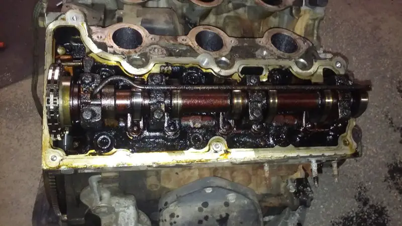

I've seen this before
Clogged spray bars
Example my old engine with 200k on it all original
Look it the surface of the camshaft lobes the spray bars is not providing any lubrication
Ill bet it rattles right in between gears At 3 k rpm
when there's no load on the motor as soon as you put a load on it the sound is gone
Notice all of the timing stuff is fine
Drove me nuts for a couple of years I finally figured it out when I bought a new engine

As far as fixing the spray bars
pull the valve covers and look with a mirror
if they are clogged up remove them and clean them then reinstall
Ask how if you need more help
