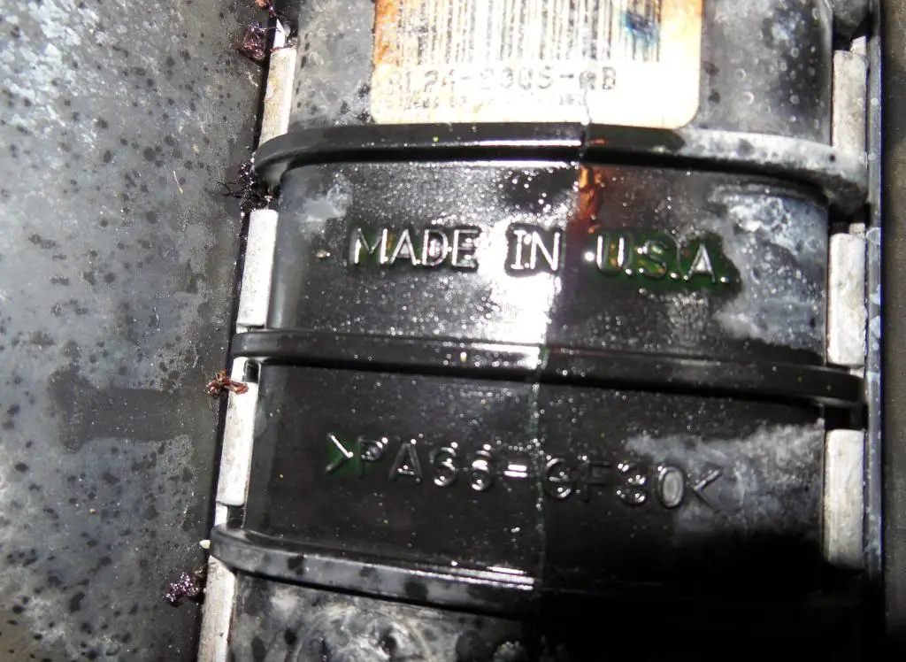

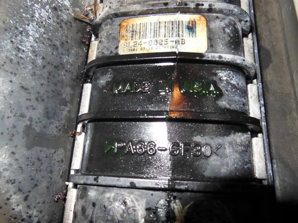

IIRC, the numbers on your radiator and the same as his. I heard the Ford "updated" one ends in -AD. Not -AB. Still, I have read that those fail as well. I know there is a TSB for the 06 EX and 07 ST's. I think it's for the 4.0's only though. Build before 8/08/06. They replace with "updated rad" and re-program the PCM to have the fan spin faster and sooner. Maybe there's one for the V8s? Sounds like there should be.

Sprung a leak today. JB Weld lasted 3 1/2 days. Oh well. Granted we didn't apply it all that great.

Also, if this guy does higher quality work (like he's telling me) and really stands behind his work it might be worth a little extra. Not sure what that means when it comes to a radiator, but other repairs it could make some difference.
