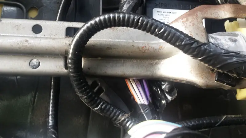

I think these pics say it all. I HATE poor design and this is pathetic. These wires should have been routed around the other side of the sharp metal edge as I did after repairing it. This seat would blow a fuse but only if you happened to be pressing the button when the wire would bounce enough to contact the metal bracket.
