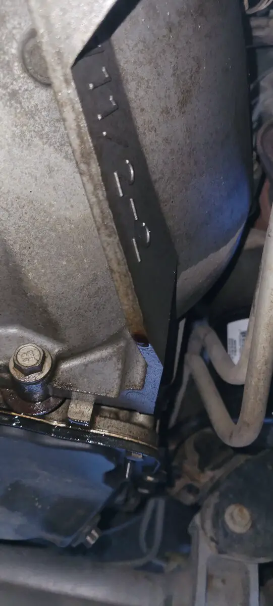

JK080, I just ran outside to take a peek underneath to check tranny cooler lines under the radiator. Nothing leaking there.. however.. I found a leak right by the bell housing, not sure if it's motor oil or transmission fluid.. assumed tranny fluid? Took a closer look at the transmission pan and can see part of the filter -- any way you can tell if this is the original one, or if the pan has been dropped before? Any ideas on how to combat the leaks, or does this help to determine where my issues are stemming from?

You cant see the filter with the pan on I believe you mean you see part of the pan gasket, its hard to tell if its new or not, plus if they dont tear when you drop the pan you can reuse them so lets not go by that.
If that is transmission fluid leaking from the front that is not a good thing, this would mean you will have to pull the transmission out to fix the leak.
I would check the fluid level and adjust as needed and clean the oil off the bell housing and drive it around and see what comes back.
