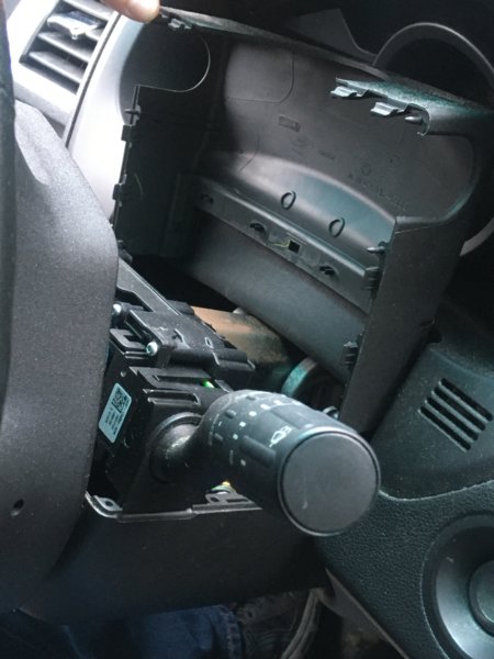

  1. Start your Explorer and turn the wheel clockwise 90° from center
  2. Pry up top cover of steering column using the three tabs facing you and also the sides

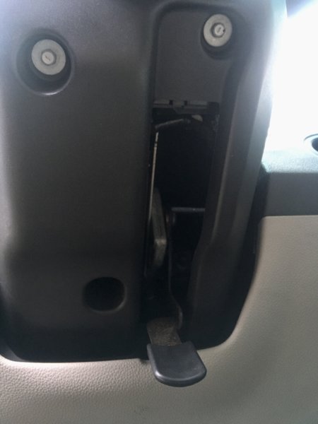

  3. Remove the three 7mm screws holding the bottom cover on. This will need to be removed to access the bottom torx screw of the wiper switch. The black screw was furthest to the back in my case. The cover should fall right off as long as you have the column lock lever in the locked position.

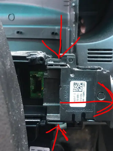

  4. Remove the two T10 torx screws securing the wiper switch. Once removed press the tabs as shown with the vertical arrows and then slide the switch to your right. If it sticks, use the trim tool or screwdriver and pry against the steering wheel.
  5. Once removed you will notice the dielectric grease on the both the module connection and also the switch pins. I took the grease off the old switch and placed on the new one. If yours is gone I would add more dielectric grease in moderation.
