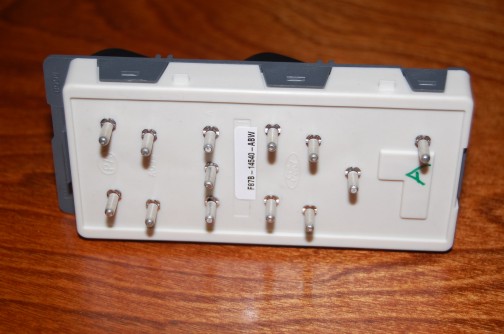

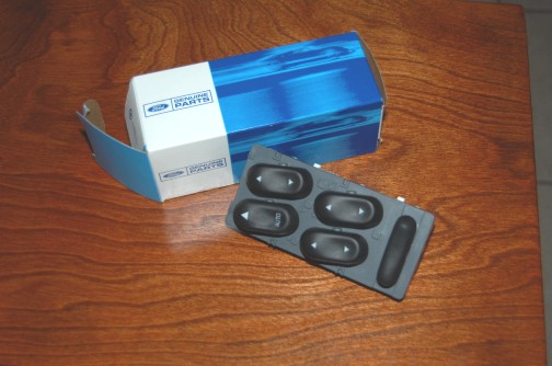

I decided to replace the master window control switch on the driver’s door. I got the new one from Torrie at Fast Parts Network (http://www.fastpartsnetwork.com/ ), part number F87Z14529AA, for $72.39 to my door via UPS.

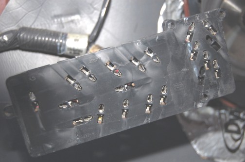

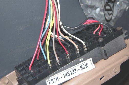

The next step was to unscrew ( 4 screws ) the bottom part of the switch from the top ( with the buttons ). Next, with a flat blade screwdriver I released the 4 tabs holding the top part of the switch to the arm rest trim panel. The switch was then removed. It was filthy in ther.
After cleaning up the mounting location, the new switch was snapped into place.
This was followed by reattaching the two switch parts and sliding the arm rest module into the door trim panel.
The installation of the new switch was the reverse of the removal of the old one.
