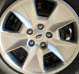

Also make sure that the lugnuts are the proper ones. The OEM lugnuts from the 20" wheel will not hold the 17" covers on. I had to get different ones that had a flange on them so that they would keep the covers on. They ran me around $13 each. Now perhaps going from 17" to 20" there may not be an issue but it is something to be aware of.

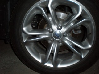

Hi Ben. I believe the brakes are the same on all models except the Sport which has slightly larger ones. You are correct that the Base steel wheels seem to cover more of the brake parts when you look at the wheel.
I don't know if it really makes that much of a difference since you will always get splashing of one kind or another that will no doubt work its way onto the brakes. Here you can see the difference between my OEM 20" and Winter 17" wheels.
Peter

Thanks for the pictures. That helps me see what the brakes look like thru the spokes
