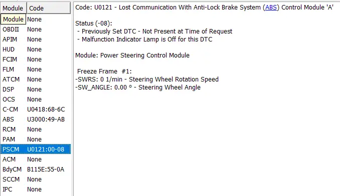

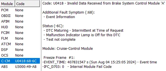

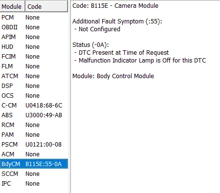

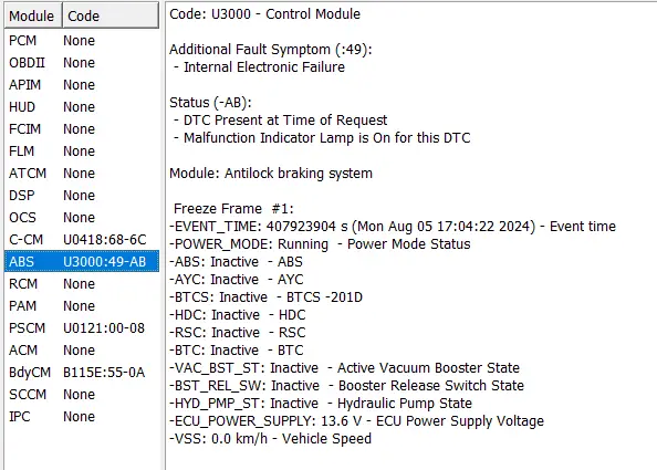

I started having ABS, Brake and AdvanceTrac, Check Brake system, service AdvanceTrac, collision warning malfunction warnings come up a couple days after purchasing the vehicle. I purchased it as is so my hands are pretty much tied there. I hooked into the car with FORScan and have attached the DTCs.

I'm no expert when it comes to this but I think the B115E Camara Module code would be a separate issue.
The rest could be related to the ABS wheel sensors. Just a guess. Here is another thread I found using U0121 as the search criteria.
