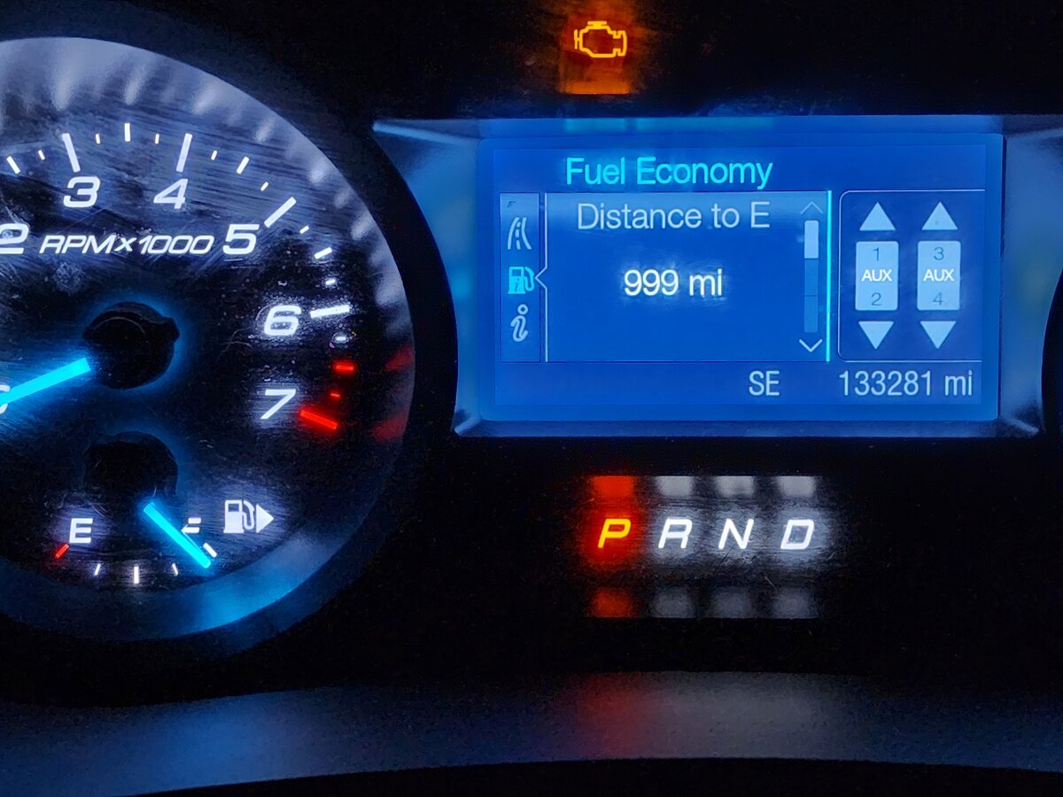

I had a weird problem with my '16. I only change one thing at a time with Forscan so it's easy to determine what may have caused a problem.
In my case, turning on the auto door locks caused the gas gauge to not work. At all...just sat at empty. The DTE showed "0". I put back what I changed in auto locks and the gauge came back..
