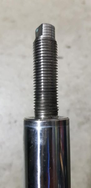

Just a quick update...the strut mounts have no ball bearings (at least I did not see any) and are actually 2 plastic sleeves filled with what I assume to be silicone grease in between gliding on each other. Part numbers are different though I see no visual differences between the 2015 and 2019 mounts.
Comparing the threaded shaft of the strut itself, the OEM has a wider gap between the threaded shaft and main shaft compared to the Bilsteins.
This gap allows for the strut mount to have a little bit of play, to allow the plastic (Teflon maybe?) inserts on the strut mount (which act as a bearing surface) to "float" & rotate freely when the nut is torqued down to 98 ft/lbs. (OEM strut and spec)
Without the play, the mount binds up completely. Bilstein tech support stated the strut mount nut should be torqued to 58 ft/lbs. No way to apply any torque without any binding...period.
I tested this by installing the strut mount minus the coil springs and tightened the nut and vice versa. And there is no way to just back it off a little, after a few hundred miles, both strut mounts (brand new) were clunking away.
So I installed the OEM strut and my old strut mounts with the nut torqued down to OEM spec. Perfect fit and no noises whatsoever. Good thing I did not throw them away.
Contacted Bilstein Tech Support and they are requesting pictures which are attached below.
First pic is the Bilstein strut and 2nd one is OEM.
I spoke to Bilstein Tech Support, sent pics and was told the gap on their strut is within engineering specifications. If I thread on their nylock nut snug, it will make contact with the main shaft and will actually fully seat when tightened to specifications. As for the OEM strut & associated parts, it goes without saying that everything torques up nicely without any binding, both using new top hats and the old ones. (which BTW are still good to go) The Tech Support person suggested I return the parts for a full refund if I disagree with his findings. I cannot return these as according to him, there is technically nothing wrong with the struts. My disagreement with his findings won't help me with the vendor as they are very specific with their return policy plus I have to pay for freight back. Other option is to file a PP dispute but to be honest, the vendor did not do anything and therefore, a dispute would be unwarranted. All issues are with Bilstein.
