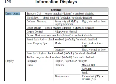

I just bought a 2014 explorer xlt 4wd two months ago. I found there's no "traction ctrl"option in "Driver Assist", just"rear park aid "and "trailer sway" .
What's wrong? Anybody kowns that? Thank you.
Thanks for your answer, Peter.
I checked the manual,but that video(4:11) makes me confused.

Thank you. I found the reason. I used forsan to change some ipc codes. I recovered the codes then it appeared again.
Thank you for reporting back. That may help others as well.
