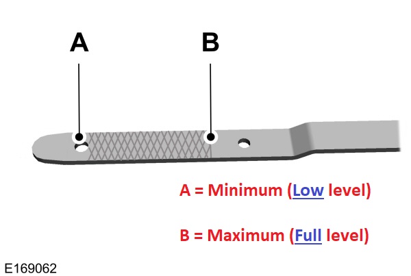

Hey guys, new to the forum. I need your help, please. I am a little bit confused about the engine oil dipstick so I need to ask: which one is the correct maximum oil level on the dipstick, the end line of the hatch OR the upper hole?

Without seeing the actual item, I'm guessing perhaps the upper hole. Where is the current level showing?
I just looked at the Owner's Manual and it shows you how to read the dipstick. The 3rd printing shows it on page 279.

The manual shows the upper hole. But, please have a look at the attached links. Each one of them indicates the opposite.
As far as I can see both the Manual and the link for the 2016 Ford Explorer Limited show the top hole as the 'Full' mark. The other video is for the 2006-2010 Explorer and doesn't apply in this case.

After this, I performed an oil change, drain the used oil completely (long time drain) and filled in the correct amount of oil stated by the manufacturer in the OM (5.7 qt / 5.4 l). Guess what? The ford focus owners are right: the maximum oil level on the dipstick is the end line of the hatch and NOT the upper hole. The OM is wrong. And when I am thinking that I had before a little bit more than the top hole...:oops: (as I told myself that it is not big deal if I have a "little" bit more than maximum)
I am attaching here an edited picture (by me) which I hope it will be suggestive for others too:

In the diagram you provided, B would be the upper or top hole and that is the one I was referring to in my posts. Of course, if you hold the dipstick upside down, then it wouldn't apply. :)
