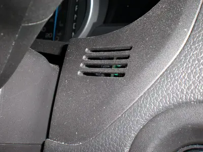

Some Ford's use a temp sensor with a very small fan to draw interior air into it, it's usually to the right of the steering column behind a small opening in the dash with some small grates over it. I've seen those good bad making a high pitched squeal type noise.

Good idea. I forgot about that.

Pretty sure thats it too.
