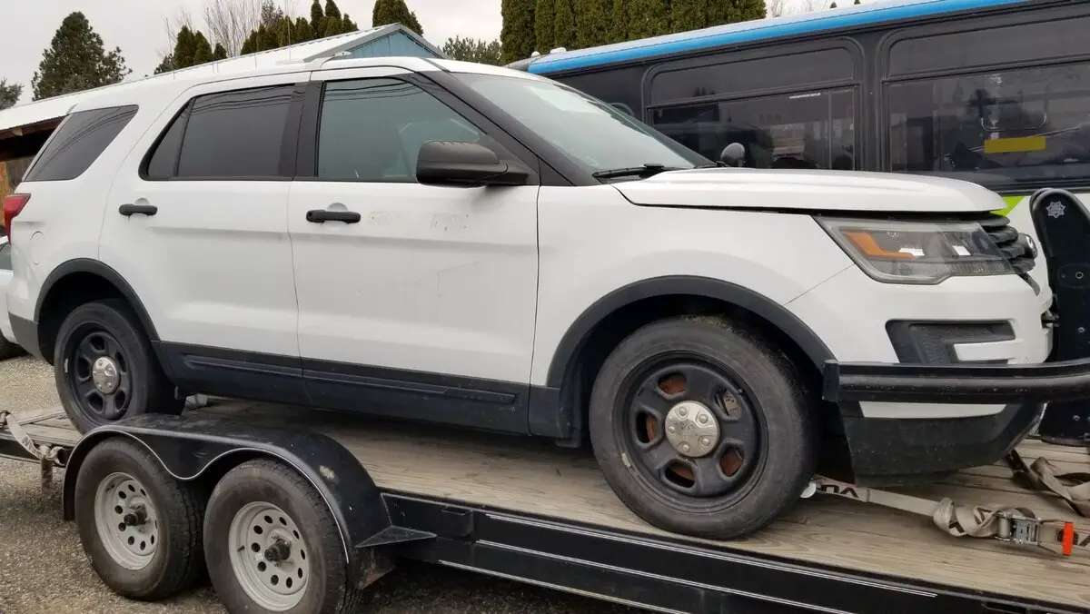

I just bought a 2017 from a government auction, it was involved in an accident (broken driver's front control arm and some minor rear damage). Anyway, the battery was dead, so I had to borrow a jump box to put into neutral to get on the trailer. Got it home, and charged the battery (the battery was disconnected). Reconnected the battery, and started to clean it up and check things out. Then I noticed that the headlights were on, could not really tell because it was in the middle of the day and I wasn't really working on the front of it. The headlight switch seams to work fine, it just that the headlights won't shut off.
Any ideas on where to start?
Thanks
