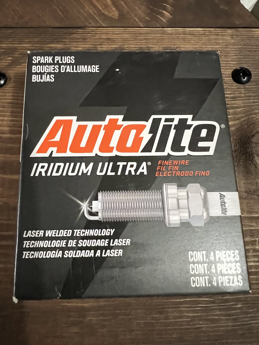

Hello All,
I am currently going to undertake changing out the plugs on my 3.5 Ecoboost.
What I am looking for is what is the factory gap I should be setting these at?
What is the factory torque spec to tighten down the plugs too?
Should these have anti-seize on them or not?
And any installation advice on the back 3 that is a tighter space?
The photos is the plugs I will be installing.
Thank you all!

So I have finally started this job… and coil pack number one… the absolute easiest to get to is so tight in on the spark plug that it won’t budge… yes I have the screw removed.
It comes up maybe 1/4 inch and can wiggle it side to side a little.. but that thing is cemented on the damn spark plug.
How am I supposed to get it off there without destroying it??
