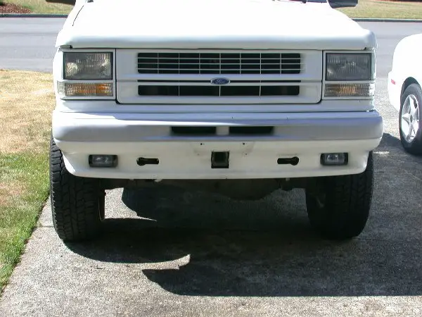

Pictures!
Well, I was going to take some pics at work but our digital here requires you to lighten everything and they look washed out.
Still need to figure out a rear bumper solution and some washers I think will fix the front-or elongating the holes with the dremel grinder- depends on how lazy I am. Also the wiring for the transfer case doesnt reach unless I pull out the gromet under the truck so I will have to figure a way to lengthen that.
looks good! :thumbsup:
