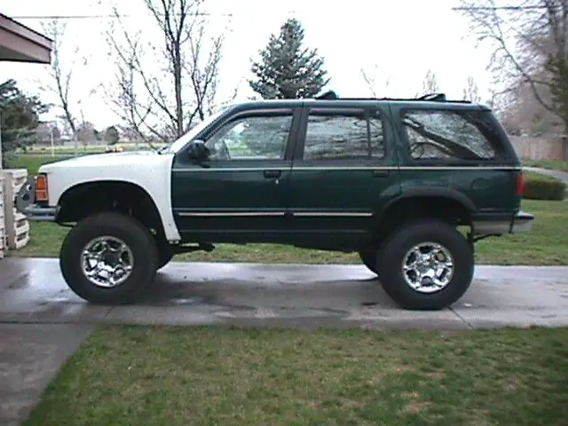

Here is my Explorer with a 6" suspension lift and 3" body lift. I clear 35's with no problem at all. Had to do a little trimming at the bottom edge of the front fenders, but otherwise they fit with no problems.
Dead Link Removed
Here it is finally. 6" Superlift, extended radius arms, superrunner steering, fiberglass fenders, RS9000 shocks, JKS quick disconnects, soa+aal 315/70R17 (35x12.50R17) BFG AT/KOs, and 17x10 AR Atlas wheels.
Sorry about the poor pic. My camera has gone to hell.
