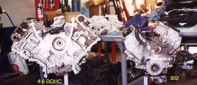

On a light note, here's a picture from some of the beginning stages of a Paxton SN-series supercharger that a friend and customer of mine has installed. He's having the head unit rebuilt as we speak and should have it back together this weekend. It also has the better flowing impellor wheel and the paxton cooler, Coupled with achol injection for detonation supression and a custom tuned Apten chip we're headed to the dyno probably next friday. With a similiar setup, using an Eaton MP90 on a stock SOHC with no chip tuning we made 247 RWHP and 290 FT/lbs of torque at the wheels. Given that this one has a chip and a more aggressive S/C we should be a bit higher hopefully.
We'll see!!
Later Doug904.
SOHC with a Paxton picture.
