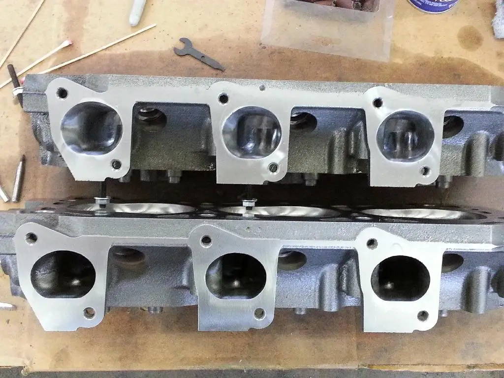

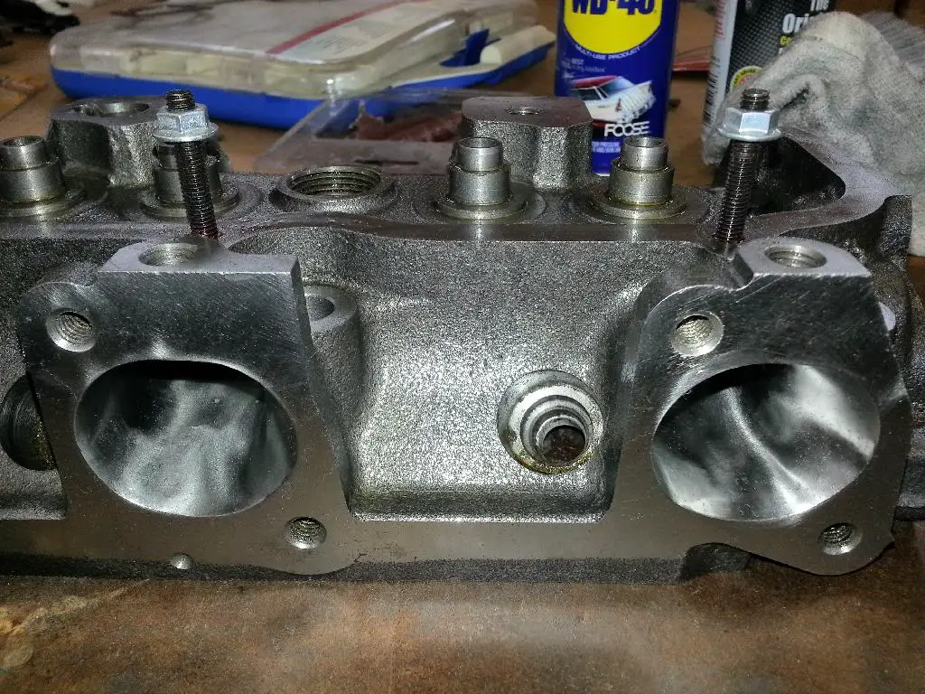

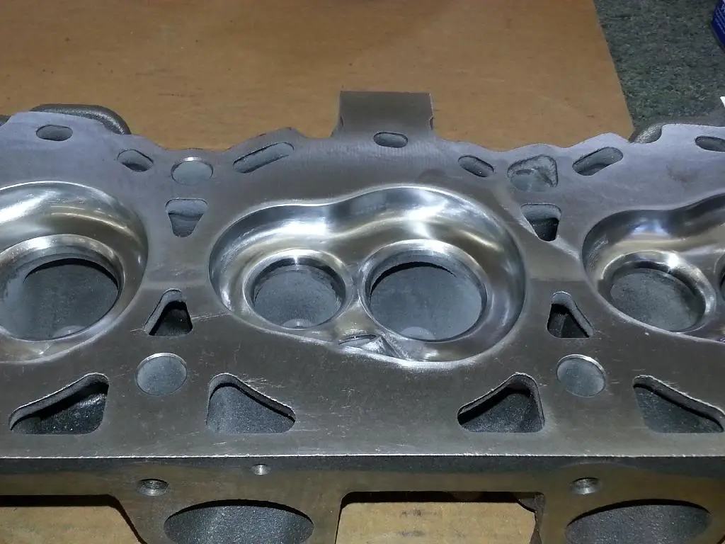

I searched around for some 'tips' on port and polishing the heads on my 4.0. I remember a thread while back where Doug904 was talking about being careful with the exhaust runners. "If you do port the heads on the pre-98's don't remove the exhaust bumps in the ports, you'll find holes underneatht them." -
For those of you that have done it, do you have any tips for me? Match the gaskets and have at it? hehe
I plan on running the 422 comp cam, but i might end up with the 410 cam due to money and time restraints. Any Input will be appreciated.
