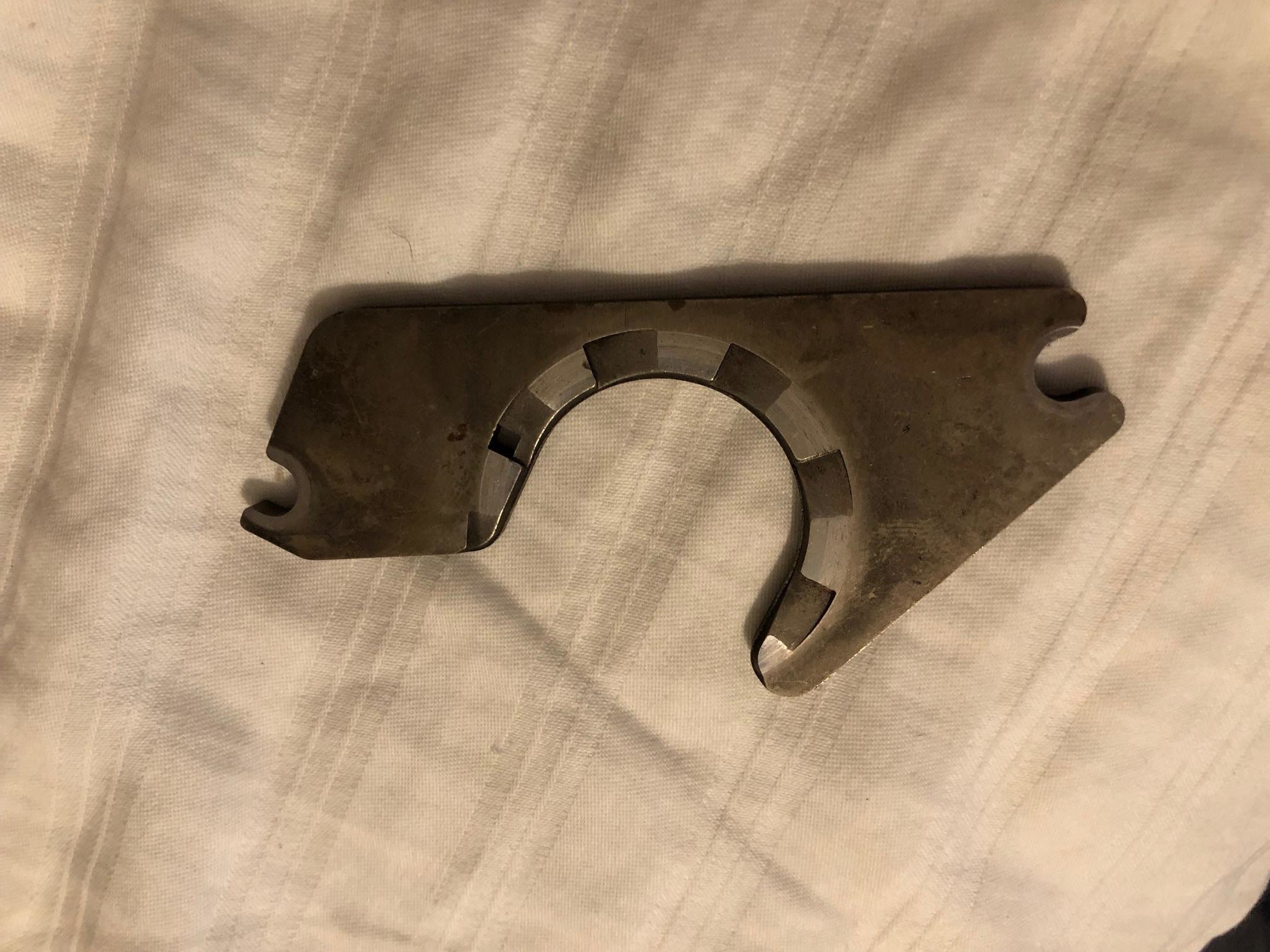

I just had an engine shop completely rebuild (but not reassemble) my 1999 Explorer 4.0 SOHC engine and I’m completely stumped on 1 part that I’m starting to believe doesn’t belong to my engine. It looks like a distributor bracket to an 80s domestic vehicle, but hopefully, someone who has rebuilt the same 4.0 SOHC can say if I’m mistaken. I just don't see where it would/could go on my engine and the shop could have accidentally put it in my parts box.

If it goes to your engine, ask @2000StreetRod. He'll know I'm sure.

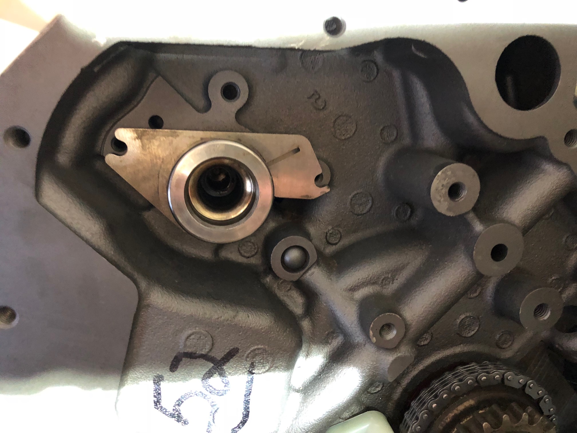

I think I found it. It's a bracket for jack shaft that goes on the front?
Looks like that's where it fits.
Yes that is where it goes but you have it flipped around. The first pic faces out when installed.
Yeah, I thought it looked like some sort of thrust plate, but I had no idea where it went.
