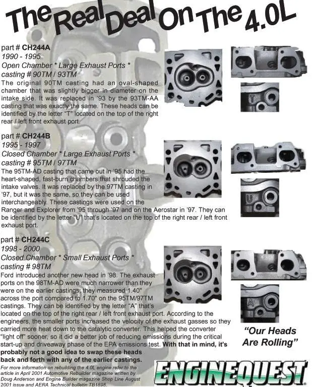

Yes I obviously read your posts, since I've been trying to find answers to the same questions.
That is how I came to find this page from Engine Quest.
I am merely affirming what you said, and added this to support you.
Hopefully also to help other people who are going through the same trouble as I have been looking for the correct heads.
I can neither affirm or deny the quality of the heads, but they do at least understand that there are different heads between 95-01, unlike many other retailers.
This page has lots of good info.. and some pics that will help.

I didnt mean any offensive by that,just didnt know if you saw them.yea big difference. Ive used and installed them on a couple motors.great heads,flow more and a great company.

Okay I've read every thread out here about the exhaust port differences between the 95tm stock head (with the 'U' stamp) and the new heads out there (98tm) with the SMALLER exhaust ports.
I ordered new heads from clearwater and I told them I have the larger ports style head (95tm), and of course they were delivered today and the new ones have the smaller exhaust ports (98tm).
I understand that the smaller ports were designed to increase exhaust gas speed and heat up the cat quicker for cold-start emissions improvement.
My question, which I haven't read fully/definitively answered in the other threads is:
If I put these heads on my 96 4.0 Engine, will there be problems or performance issues? I am just looking for a reliable, well running truck again, but I do not want to install these if there will be noticable side effects to the engine peformance.
Other threads say 'probably not a good idea' to use the 98tm heads, but my thought is did Ford change the OHV engine in other ways after these heads were released to production so that the 96 4.0 engine would not perform correctly with these heads?
Anyone with some concrete opinions on this? Would like to complete his job this weekend unless there is a strong reason to return these heads.
Thanks, Jon
Bump for an answer, cause I'm in the same boat.
They make true 95tm heads,engine quest makes them.if you use a 98 on a 95 it "could" overheat your cats.personally i dont think it would mke a difference at all,you may feel a "slight" power loss.i doubt anything was changed ecm wise,just to small of a difference on a stock motor.
