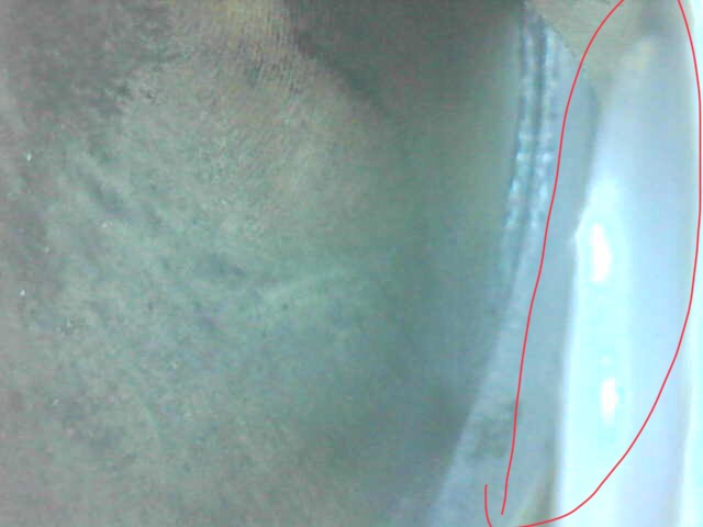

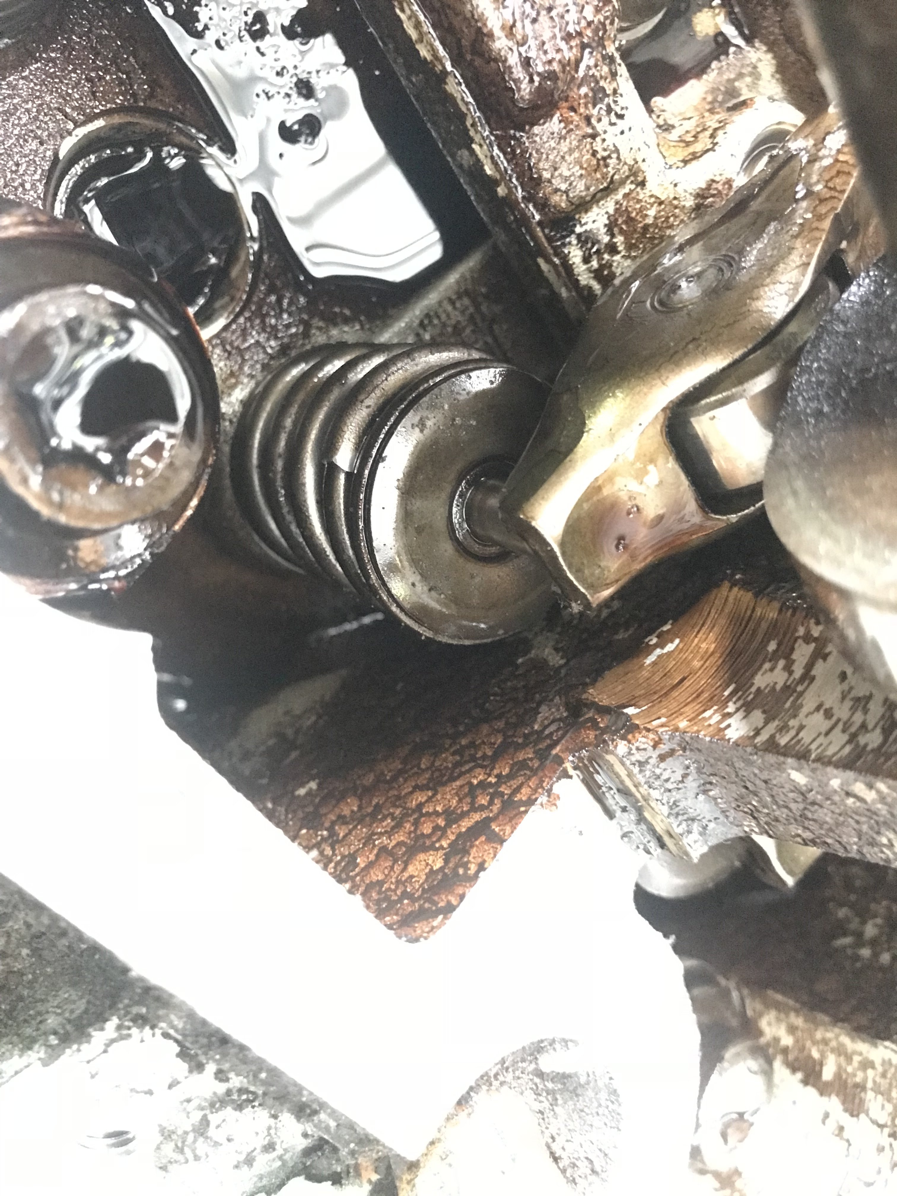

Well I finally got around to finish compression testing the passenger side. Problem solved!? Or at least found. Broken spring. Looks like the valve still closes partially. Doesn’t appear to have struck the piston. No compression though. Leakdown test blows straight through the exhaust. I was getting ready to take off the heads, but see quite a few people replacing individual springs without removing the cam. Looks doable so I figure I will give that a try just for kicks. All of the other cylinders are 165-170 so I bet this engine has some life left. Bore scope came in handy. It was cylinder #3 exhaust valve that failed just for reference. Lip of the valve is circled in red. That cylinder is at tdc so it obviously not right.
