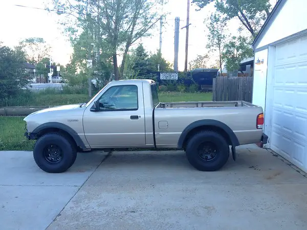

I read all the good write ups on how the 4404 transfer case works and how to rebuild and from that info I would guess it does but wonder if anyone has any experience with that. The reason I'm asking is I'm building a Explorer V8 AWD swap into a Ranger that I'll be using for ice racing and if the front disengages when I get out of the gas the car will rotate into the next turn and that is a favorable thing.
Here is the project...
