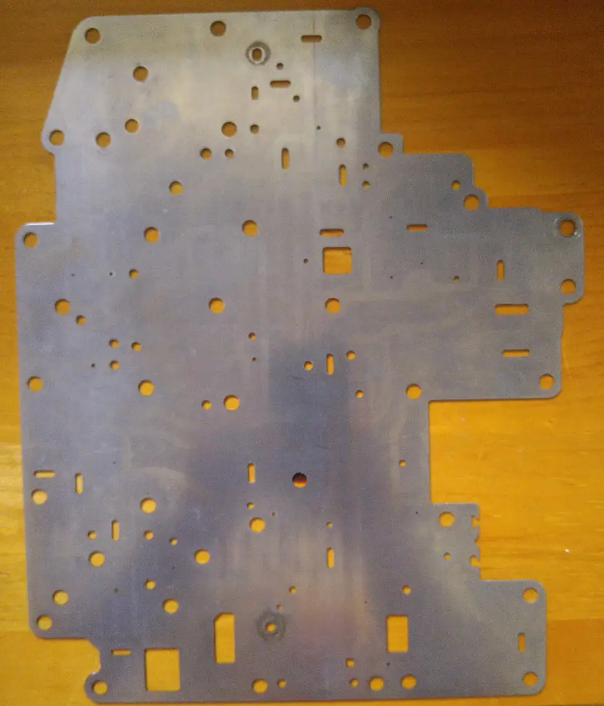

I have the separator plate out of my trans, 2001 Mountaineer, but I cannot find any images like it on the internet, and I have searched. Just ask my wife how frustrated I was.... she left the room. I have searched with many different search terms, and cannot find an image that matches what I have.
I was thinking of drilling holes bigger, etc as others have done, but nothing matches. There is no hole #5 in my plate. (per all the jmod photos I can find) Anyone know what plate this is? My truck could have a different trans from stock, maybe?
I have new gaskets that appear to fit, although there is a 'hole #5 ' in the gasket. Gasket part #s are XW7Z-7D100-AA and 1L3Z-7C155-AA
20150816_090910 by Jamie, on Flickr
apparently no one else has seen this plate either!!
I ended up drilling two of the holes in my plate that matched a jmod picture, (I think holes 3 and 4) and removing the lower springs in the 1-2 and 2-3 accumulators.
Put it all back together and filled with nice new Mercon V. It shifts with authority now, really like it!! Just all around runs better.

I did, but had no luck finding a picture that matched the plate out of my explorer transmission. they all seem to be specific to the car valve bodies, which are apparently different.
mine is still running great. pulled a trailer to Iowa and back with no issues. 1-2 and 2-3 are hard shifts though, some might not like it. It slams from 1st to 2nd, and 2nd to 3rd pretty fast. I like it.
