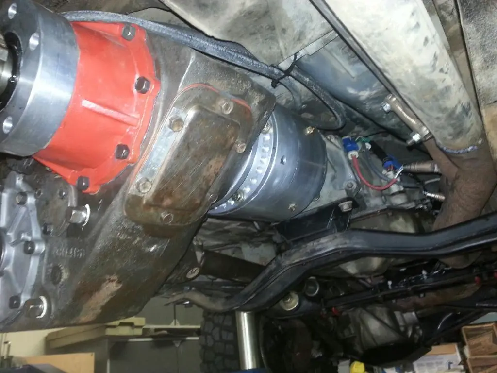

So,, What I have is a 88 Ranger that I put a 98 Explorer motor and trans in. It was a all wheel drive combo. But I have a under drive unit after the 4R70W and a NP 205.

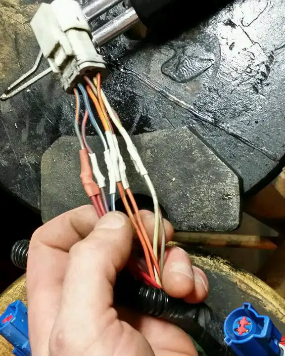

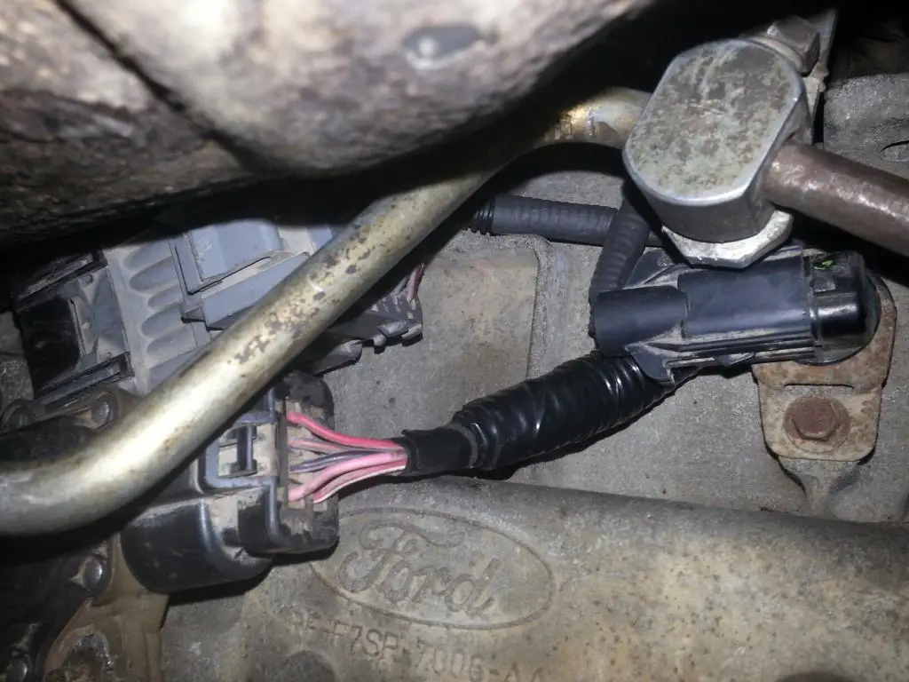

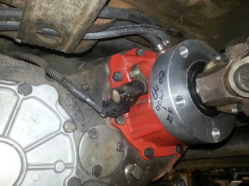

Update… I did hook up the VSS in the rear of my np205. Verified pulse.. Took the truck for a drive,, same issue with shifting as before! I found on the Explorer forum that the pins in plug # C111 need to be swapped to match the 98 trans..
So a 96 trans harness is different at plug # C111. So I swapped the pins around from the 96 harness to match the 98 C111. With the 2 power wires not used… Still have a shifting problem.

The plug on the passenger side of the transmission is re-pinned between the years. Its the same physical plug but the pins are different. I used a 97 harness with a 98 transmission and just cut the connector off the 98 harness and spliced the wires into the 97 harness.
Wiring update// questions
I did wire mine the same way!!!! Thanks for the reply!!

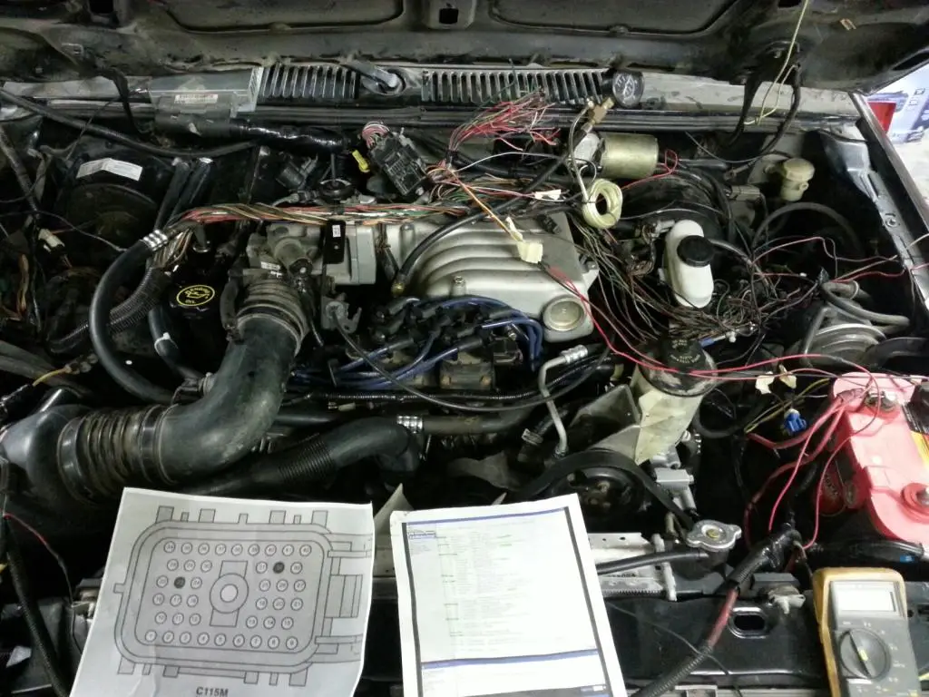

I do have more questions, I am also posting on the Ranger fourm so sorry if some of these dont make sense... I would really like some one to double look over my work, tell me what you guys think..
42 Pin 1996 plug

Ok,, can you check me to see if these are correct. This is how I have all the wires wired.....
But, I had a thought... Pin 36 is power to trans & 02,, I may not have a good enough power source to power them... After looking at what I am posting,, I am thinking this. I have that hard wired from the 88 Ranger single small wire from org harness. Ill hook up a relay with separate power source...
Also,, I did connect all 3 hot wires at trans together,, no luck there, but if there is not enough power, "like you said or lack of",, this could be the problem...
Also,, do I have a EPC and EEC????? What are they and where are they?? Sorry for the dumb questions, I am still learning but the truck is running now,, just having shifting issues..
Thanks again for everyone's help!!!Chris AZ
